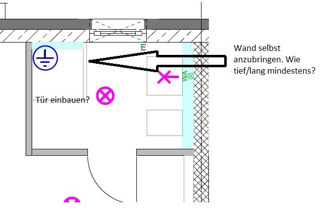

Hi,
in our bathroom (the developer is currently building the house), the shower is to be installed in a corner. On the bathroom side (right side, see photo) no partition is planned. This can/should be done by us.
There are two options:
Either just a glass panel on the right, leaving the shower open on one side, or
a glass panel on the right plus a door on the remaining side.
The shower has a floor-to-wall drain, so there is no shower tray.
Question:
How deep/long should the right side be to prevent the bathroom from flooding when using a rain shower?
And second question:
If we have this done by a glazier (area Munich), what is a fair price? According to Google Maps there seem to be thousands of glaziers offering this, and I obviously cannot contact them all.

Our masonry side wall is 1.30 m long (4 feet 3 inches), and the rain showerhead is attached to it. There is only minimal splashing; we always place a bath mat or a towel in front of it anyway. I find that with the rain showerhead, there is significantly less splashing compared to a regular showerhead, since the water streams are directed straight downward.
By the way, if the open shower is properly installed, you will not flood the bathroom, as a slope is planned so that the water flows back into the shower instead of outside.
Bieber081514 Dec 2015 20:34In my opinion, an open shower should be at least 140 cm (55 inches), preferably 150 cm (59 inches) deep. Instead of going to a glazier, I would recommend visiting a bathroom supplier who offers suitable shower partitions and doors. We received a quote for a folding pivot door, 100 cm by 200 cm (39 by 79 inches), made of tempered glass with polished silver fittings, including delivery and installation, costing about 900 euros. With a corner solution, you can roughly estimate between 1500 and 2000 euros. It’s probably significantly cheaper at a DIY store. If the glazier can offer it for less, please let me know.
We once asked a HVAC/plumbing specialist who regularly installs bathrooms, and he said that from 1.20 m (4 feet) width onward, you can do it without a door. Of course, it also depends somewhat on how you shower.
You can always retrofit later, right? If the floor plan allows it. Also, behind the 1.20 m (4 feet) space, you should of course place a towel on the floor.
Our glass wall in the walk-in shower is one meter wide. Originally, it was planned to be 1.20 m (4 feet) wide, but then it would no longer be easy to access the shower with a wheelchair. Still, no water splashes out, and both my men are around 1.90 m (6 feet 3 inches) tall.
