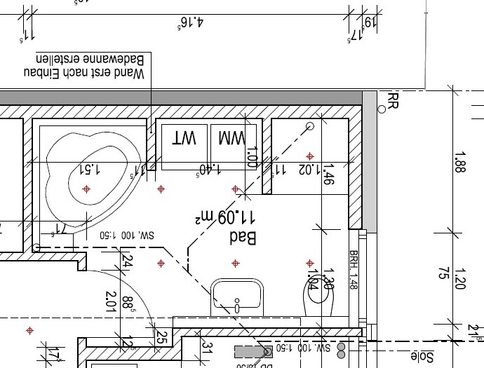

Hello everyone!
There are two options to choose from. And yes, we are sticking with the T-shaped layout, even though it’s quite unpopular. We really like it and definitely do not want a glass shower or something similar.
The dimensions are 4 x 2.8 meters (13 x 9 feet).
Now we’re curious to hear which one is your favorite.
2D floor plan of a small bathroom with toilet, sink, and shower
Floor plan of a bathroom with bathtub, sink, and toilet on wooden floor

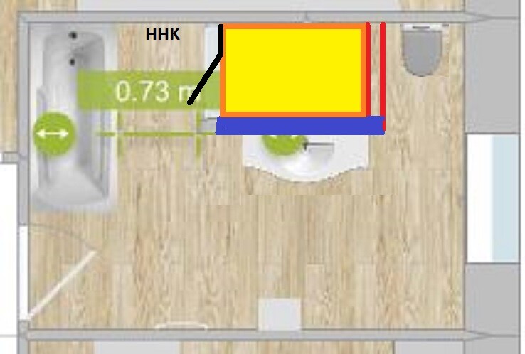

We want a walk-in tiled shower without a door, with a floor-level base. I only selected the shower tray for illustration purposes. Unfortunately, I don’t have a dimensioned plan. The room size is fixed at 4 x 2.8 meters (13.1 x 9.2 feet). The window and the door are still subject to change.
toxicmolotof
28 Nov 2017 01:00
NanDe schrieb:
...floor-level tiled open shower without a door.
Okay, floor-level is fine, no problem. Without a door? Forget about your given dimensions. You'll end up with water running all the way to the toilet. Alright, that was a bit blunt, but I know what I’m talking about. The theory that water stays within 100 x 100 cm (39 x 39 inches) only works as long as no one is standing inside.
I strongly recommend you go for at least 120, if not 140 cm (47, if not 55 inches). Or maybe consider a glass door after all. With 4 x 2.8 (13 by 9 feet), you can cause quite a bit of damage.
Here’s my suggestion, but please make sure the niche for the toilet isn’t too small. This way the “without door” idea could work.
In principle, you could even extend the washbasin and the blue wall downwards into the room by 20–30 cm (8–12 inches). That would create a huge shower.

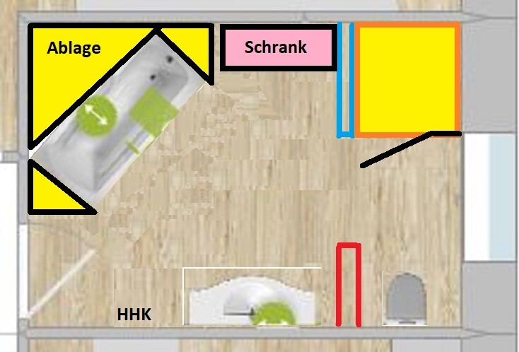

Maybe something else will come to mind later. Actually, you can do a lot with the space. Something like this, or a bath with a slightly (or strongly) slanted side top left...
Room plan: left shelf and cabinet, yellow piece of furniture on the right, red U-shaped rack

toxicmolotof
28 Nov 2017 11:48
The upper version has a T, but I just call it an L. The lower version has the T split apart. Now there are two I’s. Maybe add... The red I also exists in a half-height form. Basically not an I but an i.
