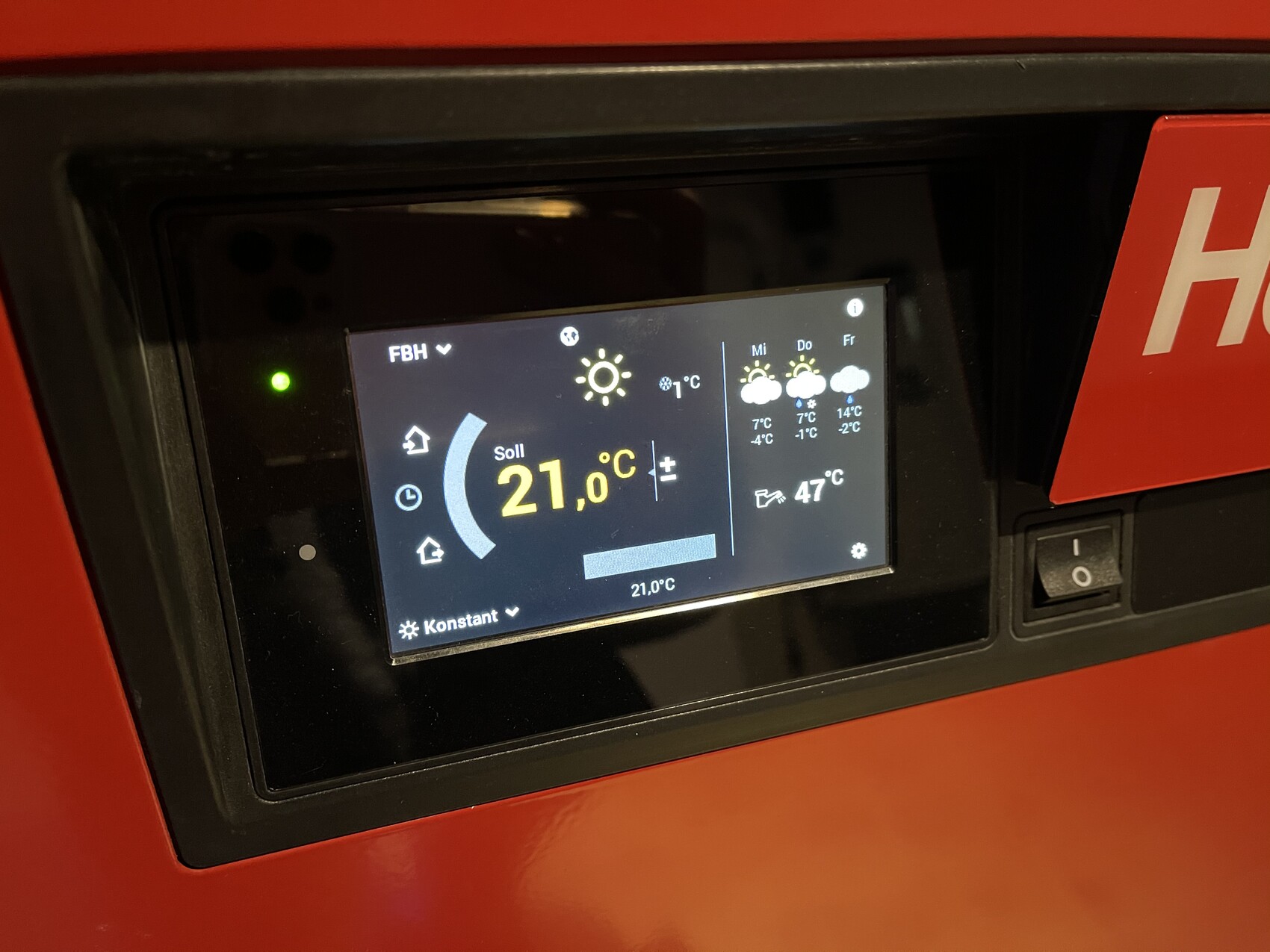

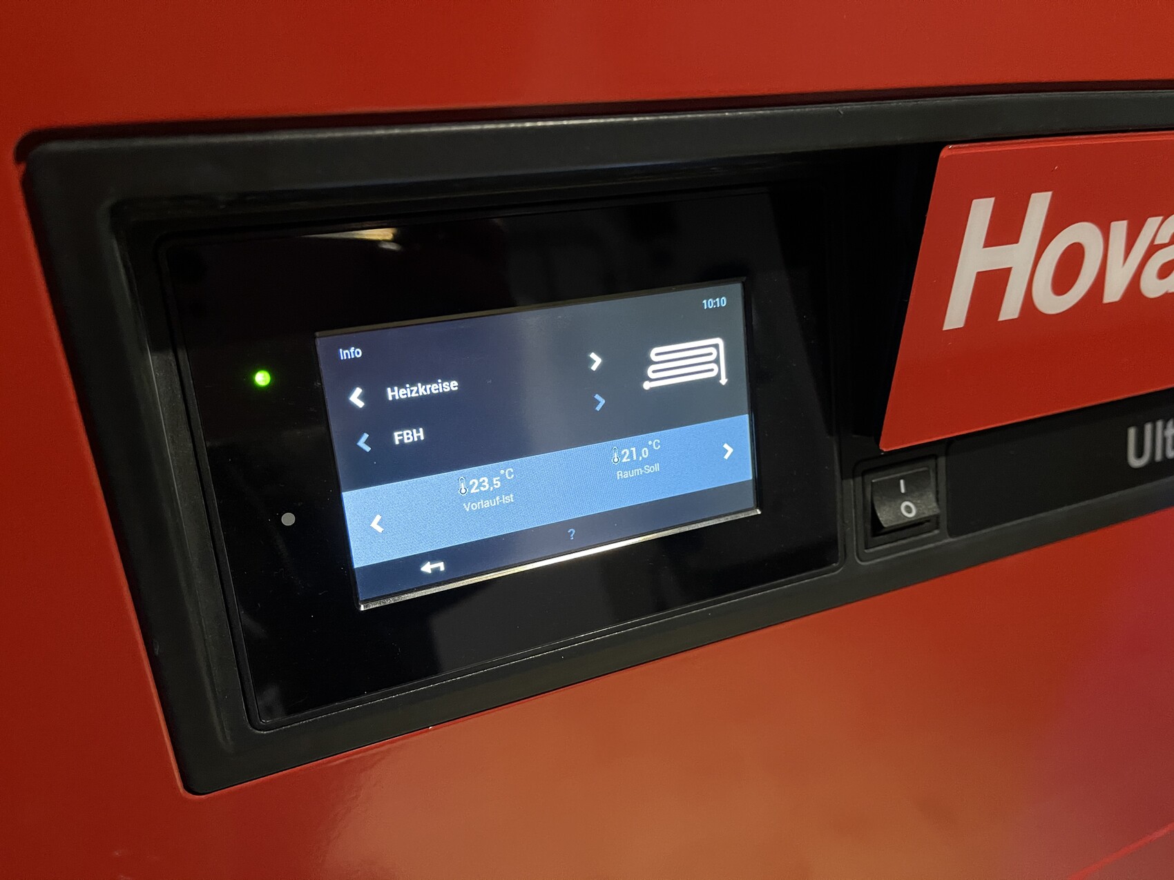

Chase1543 schrieb:
It’s a KfW40+ solid construction.
What can I say? I did some research myself and experimented a lot. At the beginning, there was a lead time with a temperature of 31°C (88°F). That used a lot of electricity. Now I am able to reach the target temperature everywhere except in two rooms. But I will try the previous tip for those.
The heated area is about 360m² (3,875 sq ft), and 21°C (70°F) is set in all rooms.
To be fair about the electricity consumption, no hot water was used!
Unfortunately, I don’t know how to create a file. I’ve attached some photos:
I’m pleasantly surprised. What is the composition of the building envelope? KfW40+ with a basement isn’t monolithic construction, right?

@Chase1543 how long has it been running now with this low supply temperature?
What temperature are the two cold rooms at?

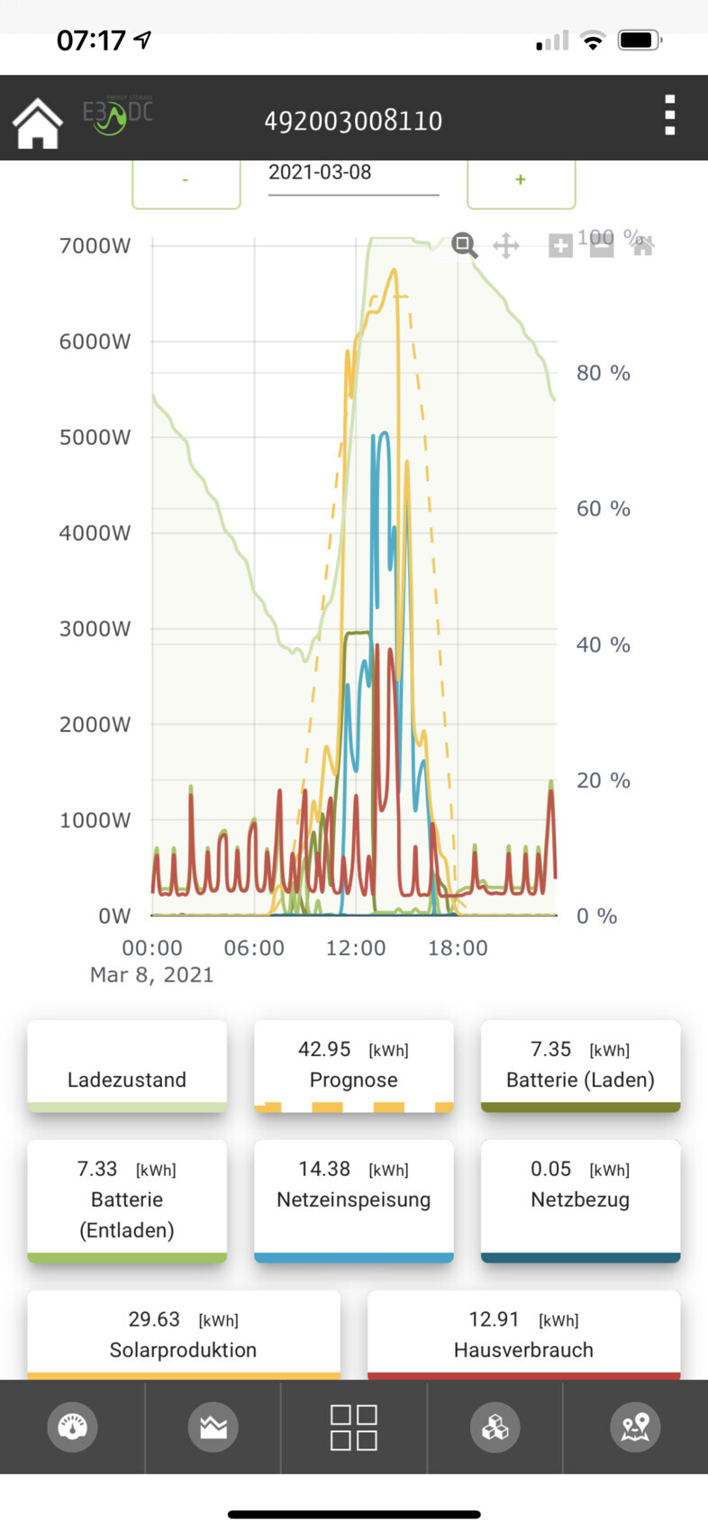

So, the 4K hysteresis is really not ideal in terms of efficiency. House consumption is 15.4 kWh (15.4 kWh), with about 10 kWh (10 kWh) used for heating and hot water.

I’ve read this several times, but I don’t quite understand the statement. I can only either gain or lose something. I can’t lose anything because I can’t gain it by self-consumption and vice versa. Anything I feed into the grid I can’t consume myself, so I’m not losing any “free kWhs.”
There are no free kWh. Have you ever calculated what 1 kWh from your storage system actually costs you? You definitely have the feed-in tariff from the Renewable Energy Act for every kWh you produce, and no one can take that away from you.
