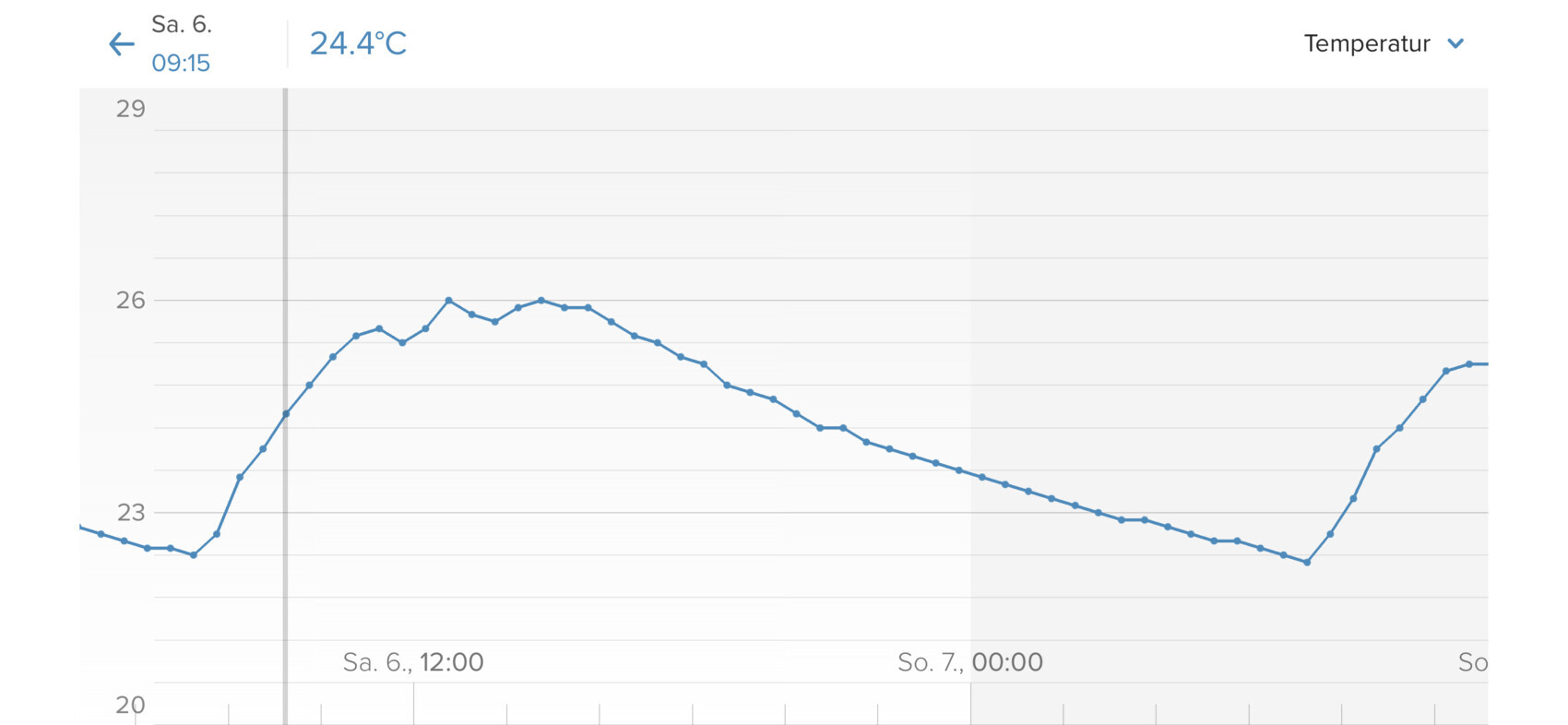

My goal here is to avoid unnecessary heating costs.Then you just shouldn’t ventilate by opening windows. This is what one heating day per day looks like for me on the ground floor. The curve on the upper floor is similar, just a few degrees lower. Unfortunately, the bedroom was always too warm at 21.4°C (70.5°F) in the evening. You can’t have everything.The return temperature this morning around 10 a.m. was 22.0°C (71.6°F). The target return temperature is 24.2°C (75.6°F). Currently, I always increase heating between 11 a.m. and 12 p.m. to 4 K (4 K = 4°C / 7.2°F) above the target return temperature.
