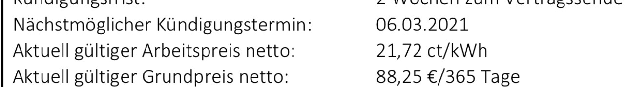

Excerpt from a price table showing the cancellation period, earliest possible date, and net prices.

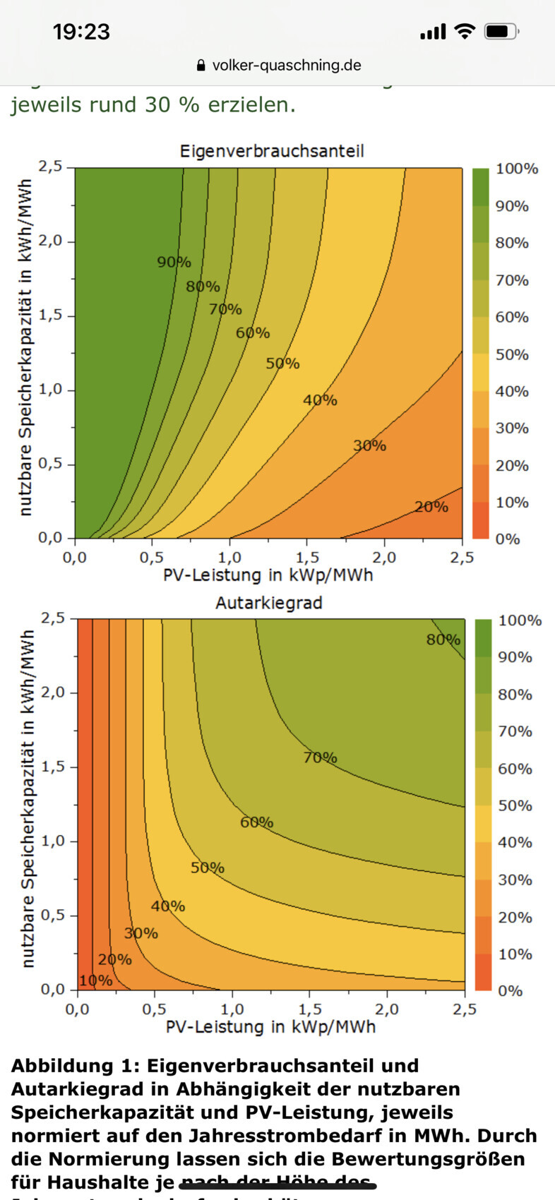

I ordered a 2.56 kWh (2.56 kWh) storage expansion today. €585 gross per kWh. Somehow, the money has to go somewhere. Based on the graphic, my ratio is 1.19 for the storage and 1.15 for the photovoltaic system (see X and Y coordinates), assuming a total household consumption of 7,500 kWh (7,500 kWh).
This might be of interest to some (@tomtom79). Unfortunately, I can’t share a direct link. Just search for the name of the figure if you want more details.
Two contour plots: Self-consumption rate above, degree of self-sufficiency below, each by PV capacity and storage size
