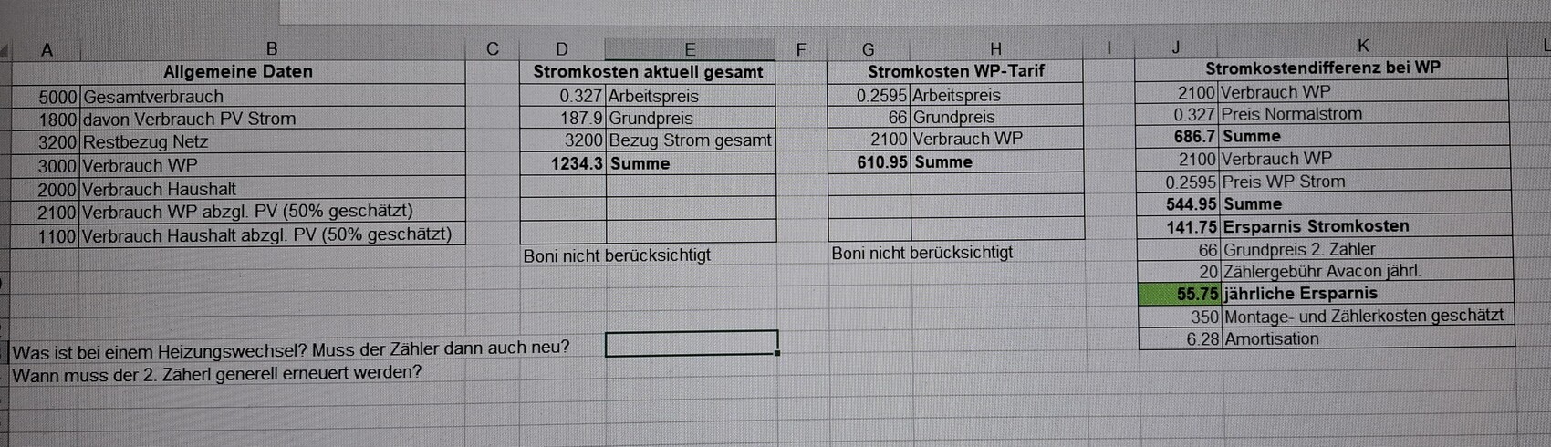

Hello, I am currently looking into the possibility of installing a second meter for our heat pump. About us: the house is 5 years old, KfW "42" standard, 150 square meters (1,615 square feet), photovoltaic system, air-to-water heat pump.
Attached is the calculation I have put together. Could this really be correct? What else should be taken into account?

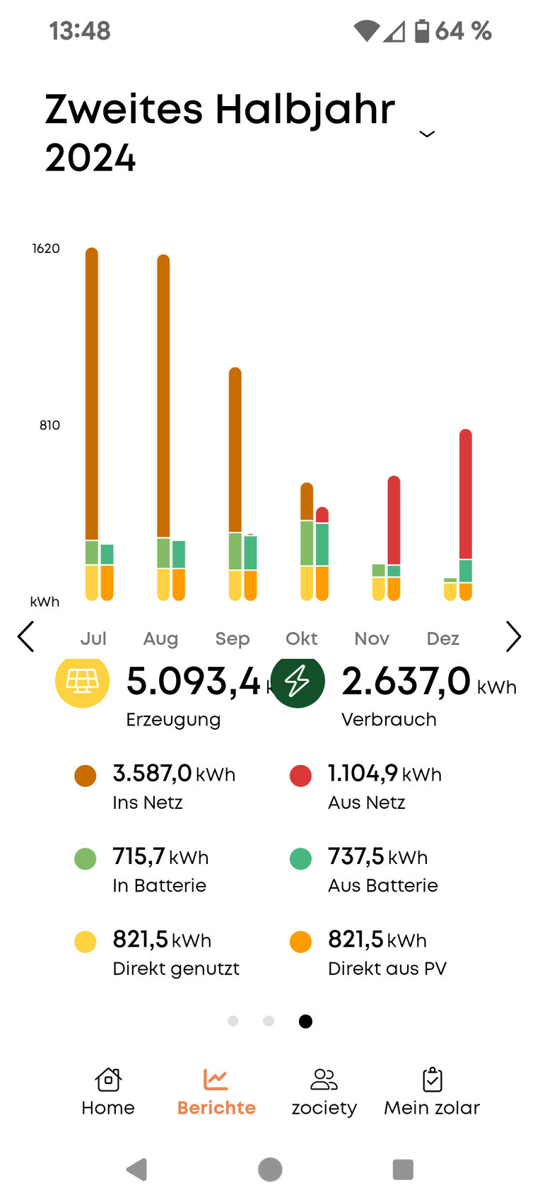

The consumption of just under 5000 kilowatt-hours (kWh) is correct and has stabilized since the second year in our home with 2 people.Our consumption is also about 5000 kWh, with a photovoltaic system of 13 kWp and a battery storage of 10 kWh, the grid usage remains around 1500 kWh per year,
which is not worth dividing further on the meter.
Neuer von Da7 Jan 2025 19:51Having two meters is rarely worthwhile.....
Expansion also costs money.
Unfortunately, we have two meters installed.
And only because the basic fee is so low is the heat pump meter still worth it.
