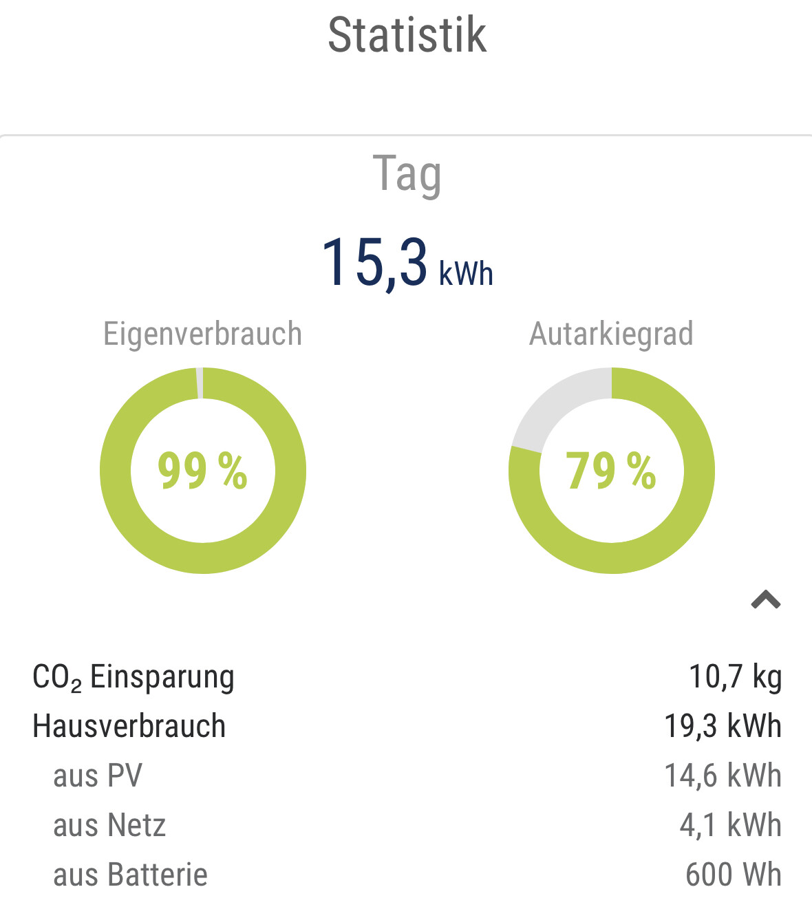

A very nice day so far...
...and the car is still charging 😎
Statistics dashboard: Day 15.3 kWh; self-consumption 99%, autonomy 79%; CO2 savings 10.7 kg; PV 14.6
