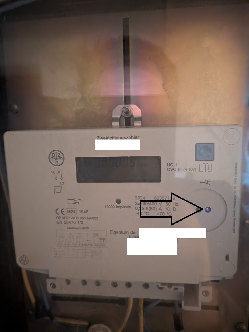

We want to find out if these are connected to our meter.
What is the best way to do this?
This is the meter in our apartment.

Jodimaster2k12 Jan 2026 11:14There are nine fuses, right? One is positioned deeper than the others? (See photo)

nordanney12 Jan 2026 11:42Jodimaster2k schrieb:
It will probably take a long time for the meter to increase by one if it’s only lighting.Look for 300-watt light bulbs on classifieds or online. Then it will go faster.J
Jesse Custer12 Jan 2026 11:45Truly, truly, a profound issue.
Take another close look at your meter: next to the number, there should be a small blinking LED or a symbol on the LCD indicating that electricity is being consumed. This usually lights up even with a low load.
Otherwise, as @nordanney said: create demand, and it will react quickly.
