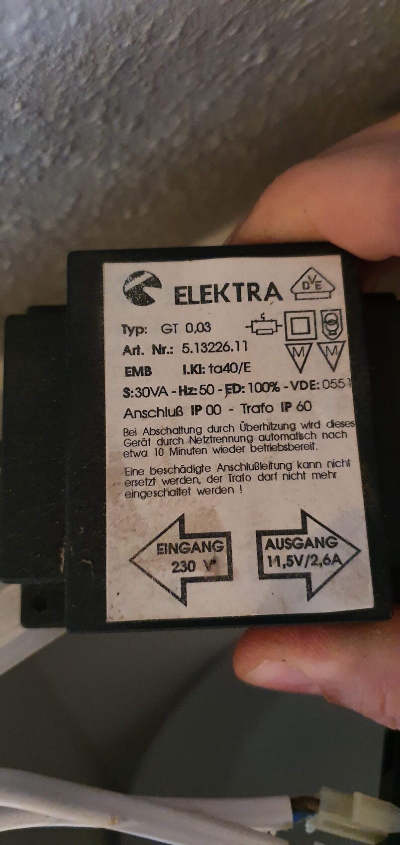

Two_Beers6 Dec 2019 11:46Hello, I bought a house and in the kitchen, the 3 halogen spotlights above the countertop keep turning off. I have checked everything, and it seems fine. Most likely, the transformer is just shutting off. I would replace it with a new one, but unfortunately, the wiring is behind the wall cabinets... Planning in 1998 wasn’t very forward-thinking. The transformer piques my curiosity, and I can’t find any information about it online. I would like to replace the halogen lamps with LEDs. However, I can’t find any wattage rating on the transformer to know what range I should be within. I took a photo of it. Can anyone make sense of the specifications?
Mottenhausen6 Dec 2019 12:00It’s all written right there:
11.5V at 2.6A
P = U*I
so 29.9W
It also says above as 30VA (Volt Ampere = Watt)
11.5V is a halogen transformer. You can easily connect any 12V LED to it. But if the transformer already shuts off due to overheating, it’s better to replace it. 12V LED transformers are almost free on eBay... For LED strips, depending on the length, you will need somewhat more power, rather around 50W+ So, depending on the density and type of chips: 10W per meter (3 feet) as a guideline.

nordanney6 Dec 2019 12:01If not here, then definitely at the manufacturer. Just give them a call at 05223-185-0.
Two_Beers7 Dec 2019 07:53Thank you for the reply. I would like to replace it, but I would probably need to take down the wall cabinets first. The cable comes directly out of the transformer right behind them. I would prefer to avoid removing them. But now I know where the overheating is coming from. There are three 15-watt bulbs in there. I’m surprised the thing even turns on... I will first try replacing the bulbs with different ones.
