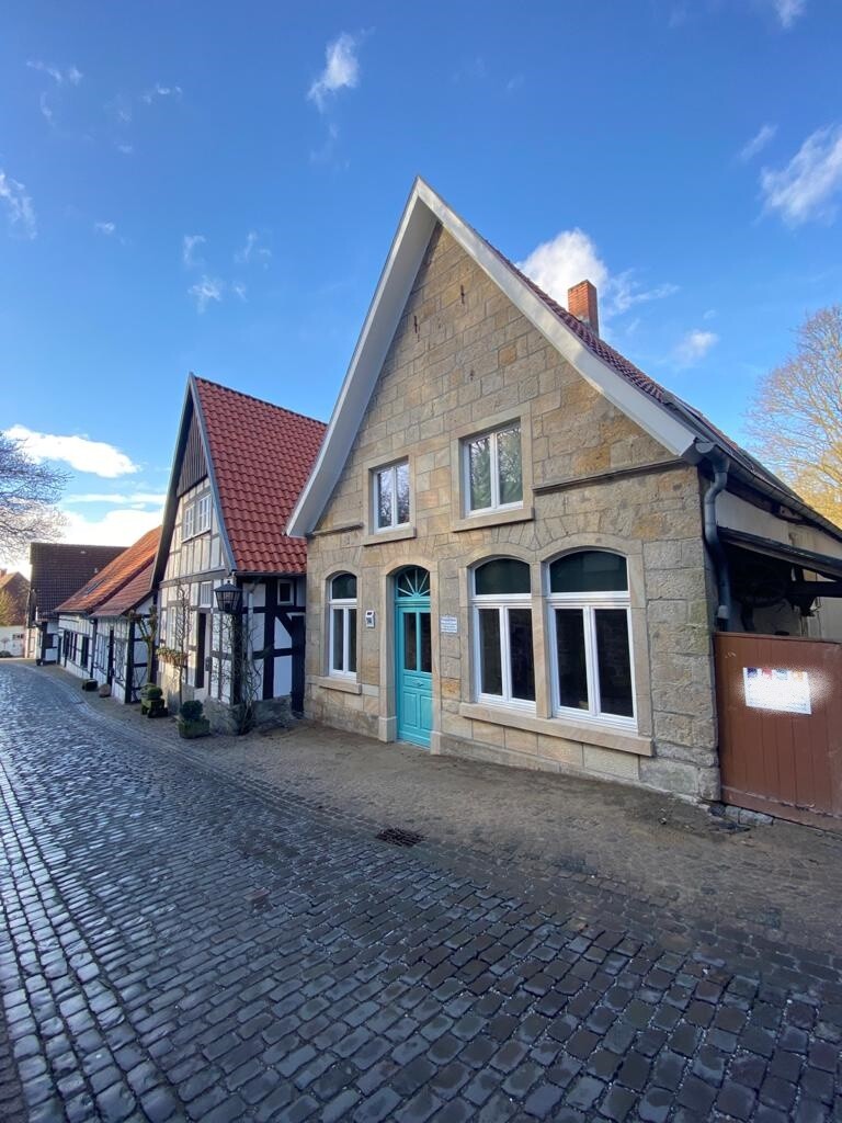

Trademark schrieb:
Relatively at the end:
The arches of the windows have been nicely reopened. But the windows on the upper floor are quite low, aren’t they? Were they originally like that? Didn’t you want to raise them higher? They have been newly installed, after all...
