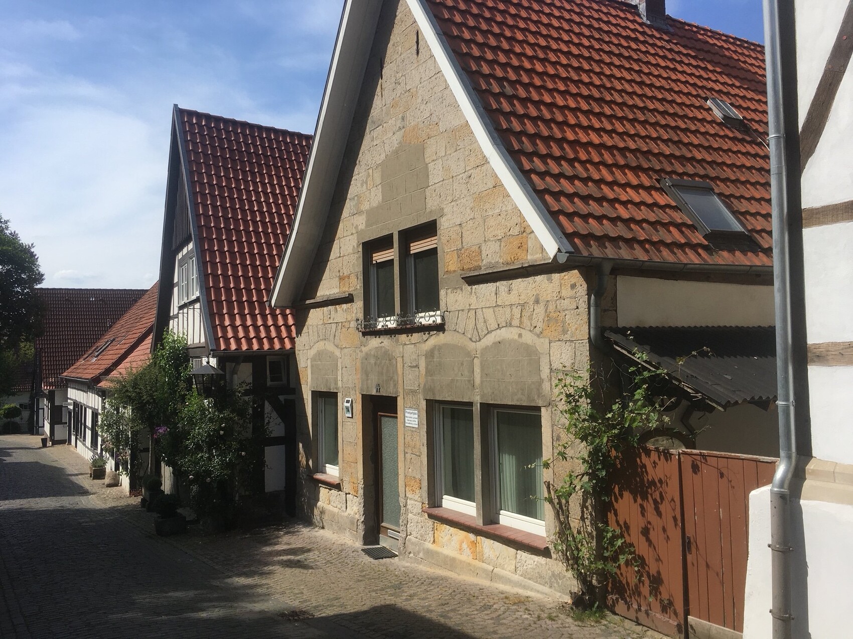

Trademark21 Dec 2021 23:17In the end, it’s also a matter of personal preference. You need to be motivated to do things yourself. You also have to be able to accept the old and possibly somewhat compromised floor plan. But you can achieve a lot if you have the budget, courage, and ideas.
Before the renovation:
Relatively toward the end:
