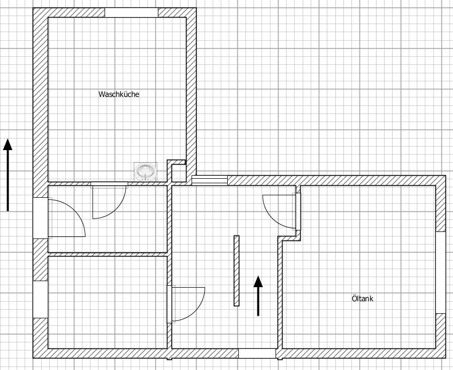

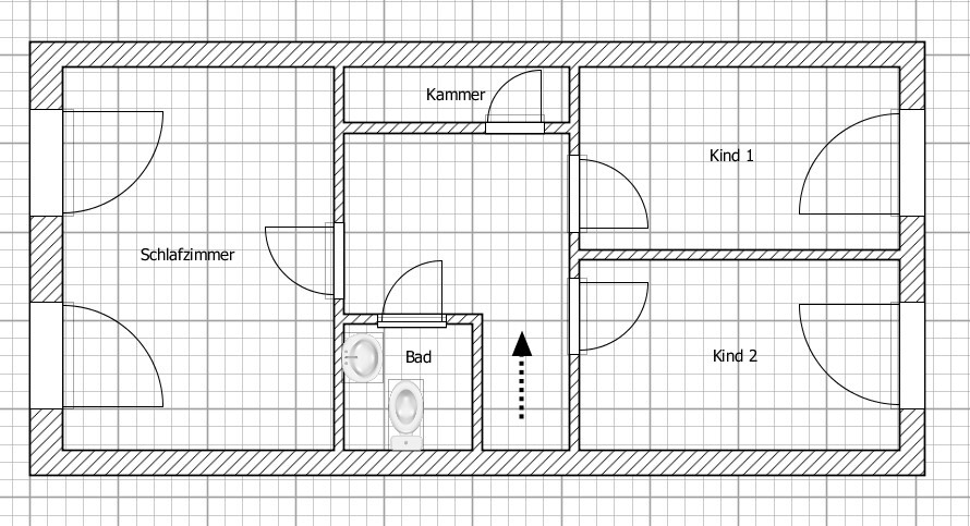

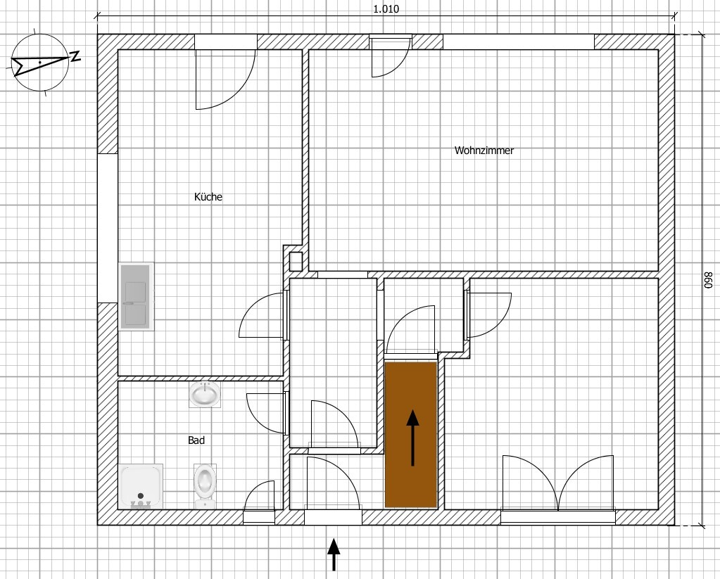

I wanted to share more photos and also tried to sketch the floor plan.
It’s my first time using this program, so the stairs are improvised with arrows...
Basement (left side has an exterior staircase leading up):
Ground floor (three entrance steps up to the front door):
Upper floor (sloping ceiling at the top on the west side and bottom on the east side, lowering to about 1.5 m (5 feet)):
The exterior dimensions are accurate, but interior measurements may vary from the scale because the numbers on the original are difficult to read. The thicknesses of the exterior walls seem to have been “adjusted,” so those were readable and should be correct (24 cm (9.5 inches) in the basement, 28 cm (11 inches) on the ground floor except on the south wall, where it is 36.5 cm (14 inches). Interior walls are 11.5 cm (4.5 inches).

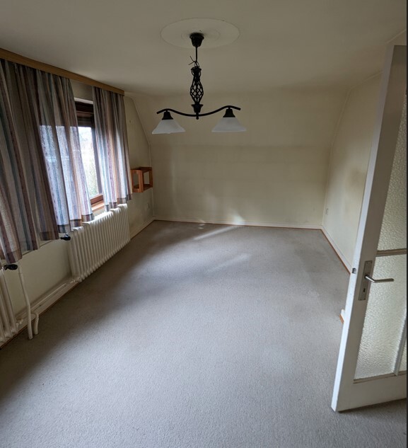

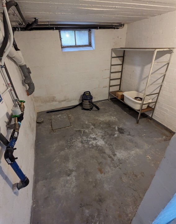

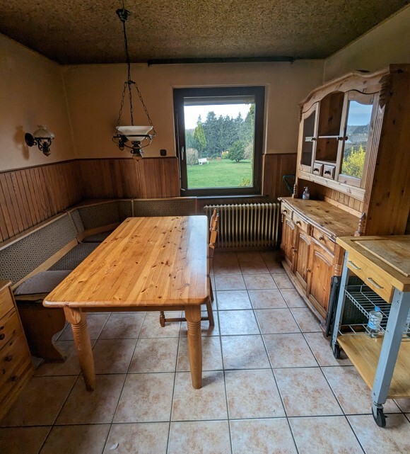

Here are photos of the rooms from the viewing at that time; all the items have since been cleared out by the seller.
Basement (laundry room):

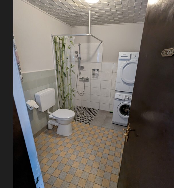

Ground floor (bathroom, kitchen, living room):
Upper floor (bathroom, bedroom, child’s room 1):
