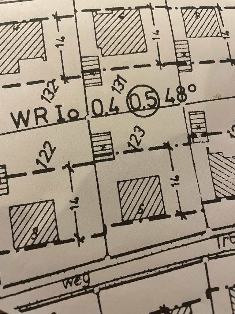

Attached is the zoning plan!
zizou89 schrieb:
Attached is the development plan! Is it supposed to be house number 5 / plot 123? If so, that’s way too little from the plan. Tell me its name (no link, please! Or email it to me, see forum search “11ant gmx”). Without the “textual conditions” included, it’s hard to say much.

So, your email has arrived, and I have reviewed the development plan. It was established in 1976 and became legally binding in 1979. At that time, your house was already standing and was effectively included in the plan as an existing structure. Therefore, the building zone for each house starts at the street-facing facade (specific to each plot, as it is not exactly the same for neighboring properties but similar) and extends 14 meters (46 feet) deep from there. For some garages, this means that if they are rebuilt in the same location, they would already require an exemption because they are too long.
The roof pitch is 48° with a tolerance of +/- 2°. The neighboring houses at numbers 9 and 11 have small lean-to dormers, apparently the only ones in this section based on aerial images. I must withdraw my suggestion for a wide lean-to dormer because requests for exceptions of that size are apparently uncommon in this area, and I see little chance of approval. Even the “dormer” shown in the image from post #51 would, in my opinion, be a precedent in this planning area.
At least there is no specified ridge orientation in this section. Despite the lack of defined height restrictions, I see no worthwhile scope for increasing the roof height without exceeding the limits for the attic as a non-full storey. I also consider the desired flat roof extension to be non-compliant with the plan and unlikely to receive an exemption. Therefore, extending the house in width while continuing the existing house profile seems to be the only option.
Due to few or no building gaps in the overall “southern part,” I see no reason, at least under the principle of appropriateness, to consider changing the development plan before potentially developing the area of the allotment gardens permanently.
I think you will have to significantly reduce the scale of your modernization plans regarding the house design. The facade, theoretically, could be your area to “take revenge,” as the development plan does not oppose that.
