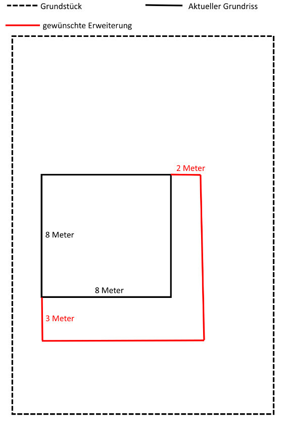

This is roughly what we had in mind:
Would this work?seref89 schrieb:

I appreciate any information.This is roughly what we had in mind:
Would this work?

Will this work?Short answer: no. But we can gladly tell you what is possible – your homework on this is in post #4.https://www.instagram.com/11antgmxde/
Summary: no. But we can gladly tell you what is possible – your homework is in post #4. Can you also explain why that is not possible? As I said, I am a complete beginner!
seref89 schrieb:
Can you also tell me why this isn’t possible? As mentioned, I’m a complete beginner!It can work if you like an L-shaped room that is 2 meters (6.6 feet) wide on one side and 3 meters (9.8 feet) wide on the other side. But 99.99% of homebuilders wouldn’t know what to do with it. Neither would I.

seref89 schrieb:
Does this work?No, because of the structural system. The floor slabs rest on the external walls, so you can’t simply remove them. Generally, the external walls need to stay in place. Door openings could still be made to access the extension with the 2m (6.5 ft) utility room.With a lot of money, it might be possible—if you had a listed facade or something similar—but demolishing and rebuilding is the route you want to take and also the most cost-effective for your plans.
Have you already purchased the plot, or is it the inherited one from your other thread? If building plots are still available in your area, it could be cheaper to move to a vacant lot without an existing building. You should get demolition quotes and compare them with other land options.
