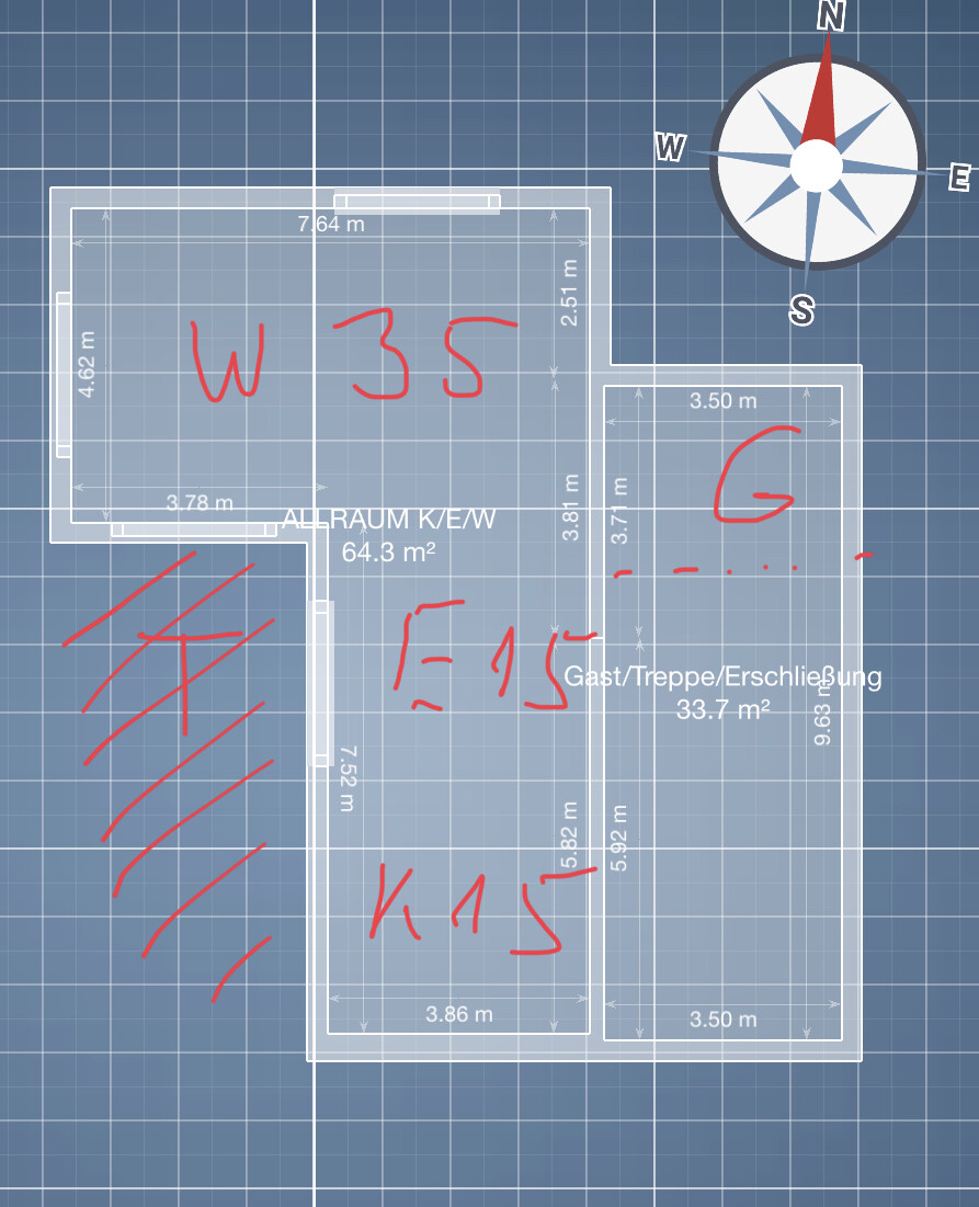

The sketch was quicker. Sometimes 54 sqm (580 sq ft) is not enough or is poorly utilized… does the amateur sketch make any sense to the professionals? The square meters can of course be adjusted if more space is needed on the right side… 8 meters (26 ft) wide at the bottom, 12 meters (39 ft) at the top towards the garden… on average it stays around 10 meters (33 ft) including an allowance.

10 m (33 feet) in length is not enough. We have 10 m (33 feet) inside. A standard sofa fits just barely. The minimum 50 cm (20 inches) that I would like more is missing, ideally it would be 100 cm (40 inches). Our table is only 110 cm (43 inches) wide. The OP is missing at least 100 cm (40 inches). Therefore, my question and suggestion is to draw in the TV and sofa.

Therefore, my question and request is to include the TV and sofa in the layout.Or omit them, place them elsewhere, have no TV in the room at all, or avoid arranging them around a corner, or...An open space suggests an area that either doesn’t exist or is excessive.
Then replace the TV with a piano, bookshelf, sound system, or whatever. The plan shows an open area in the combined living space. It’s probably meant for the living room area.
The rough structural dimension is 10 meters (33 feet) minus
the kitchen at about 3 meters (10 feet),
the dining area at a minimum of 3.2 meters (10.5 feet), preferably 3.5 meters (11.5 feet),
leaving a little more than 3.5 meters (11.5 feet) for the living area, which is quite tight. Especially since there are still doors in that space.
If you want to fit 3 armchairs, 1 small table, and 1 shelf, that’s fine. But if you want a large XXL sofa, at best the balcony doors won’t be able to open anymore.

RotesDach2 Dec 2020 10:53Regarding the living area, it is somewhat secondary for us: we have an L-shaped sofa measuring 2.15m (7 feet) in length. It fits well. If it were 50 or 100cm (20 or 40 inches) longer, we would find it more spacious. However, that also comes down to cost. Other areas—such as the kitchen island and dining area—are much more important to us, as we spend significantly more time there than in front of the TV. We want to keep the living room furnished mainly with just the sofa and the TV. We also plan to have a lowboard under the TV with shallow depth, but spanning the entire width of the wall. That still needs to be purchased or custom-built.
