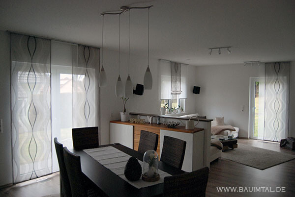

Our half-height wall is located behind the sideboard and is just slightly taller and longer than it.
It doesn’t provide complete privacy, but especially when sitting on the sofa in the living area, the wall creates a clear separation between the living and dining spaces, which we find makes it cozier.
But as mentioned, that is always a matter of personal preference.
