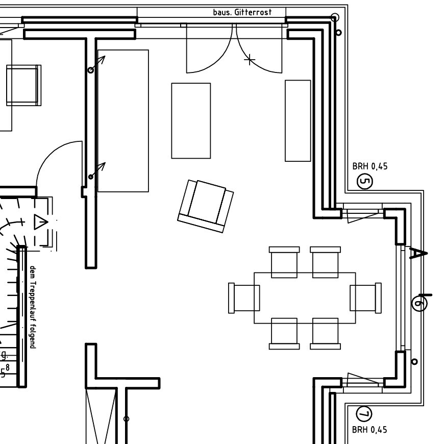

I am still not satisfied with all the options I have come up with for positioning the light points in our open living/dining area – maybe someone has the perfect suggestion?
Attached is the floor plan excerpt.
We are planning to use 230V light points for pendant lamps and surface-mounted spotlights.
The open kitchen with an island is connected to the dining area below – the lighting there is already planned.
What is certain: Above the dining table, there should be two outlets and above the living room table one light point (each for pendant lamps and separately switchable).
But how can I ensure balanced general lighting in the living and dining areas?
I initially installed two rows of three surface-mounted dimmable spotlights running from the hallway to the two corners. But then I still lack light in the living room...
And if I plan four surface-mounted spotlights in the “corners” there as well, the distances between the spots seem awkward (too close between dining and living). I also wonder if so few spotlights will provide enough light at all?
I am a complete beginner on this topic and need to submit the final plan to our builder within the next few days.
krachbumms schrieb:
B was intended as a central light source for general lightingAnd what are C supposed to be for?
For general lighting, you draw central room axes or diagonals to find the positions of the outlets.
Personally, I find spotlights uncomfortable.
I consider a hanging lamp over the coffee table to be less than ideal, as you can easily bump your head on it.
I would use a straight line and install ceiling lights in both the living room and kitchen areas. There are very beautiful lamps available on the market.
Matching the ceiling lights, I would place a hanging lamp (if there must be one) over the dining table, or: install a third ceiling light aligned with the other two lamps.
In the entrance area, I would install a wall lamp (I know) simply because it creates a cozy and homely atmosphere. The rest is taken care of by the kitchen lighting built into the kitchen furniture itself.
Each lamp should have its own switch and possibly a dimmer in the living area.
A floor lamp is optional both in the living room and in the bay window.
krachbumms18 Oct 2015 22:21Thank you for your suggestions. I have now arranged the following layout.
Living area: Pendant lamp above the coffee table, 3 spotlights along the TV wall.
Dining area: Pendant lamp(s) above the dining table, 3 spotlights in front of the large bay window, ceiling light between the entrance to the living area and the dining table.
A floor lamp will definitely be added next to the sofa.
My wife does not like wall lamps at all. There is also no spot where I am absolutely certain I don’t want to place furniture or a picture.
nordanney14 Jan 2016 20:39I would rather choose 6-7 recessed lights, but then split them across two circuits.
