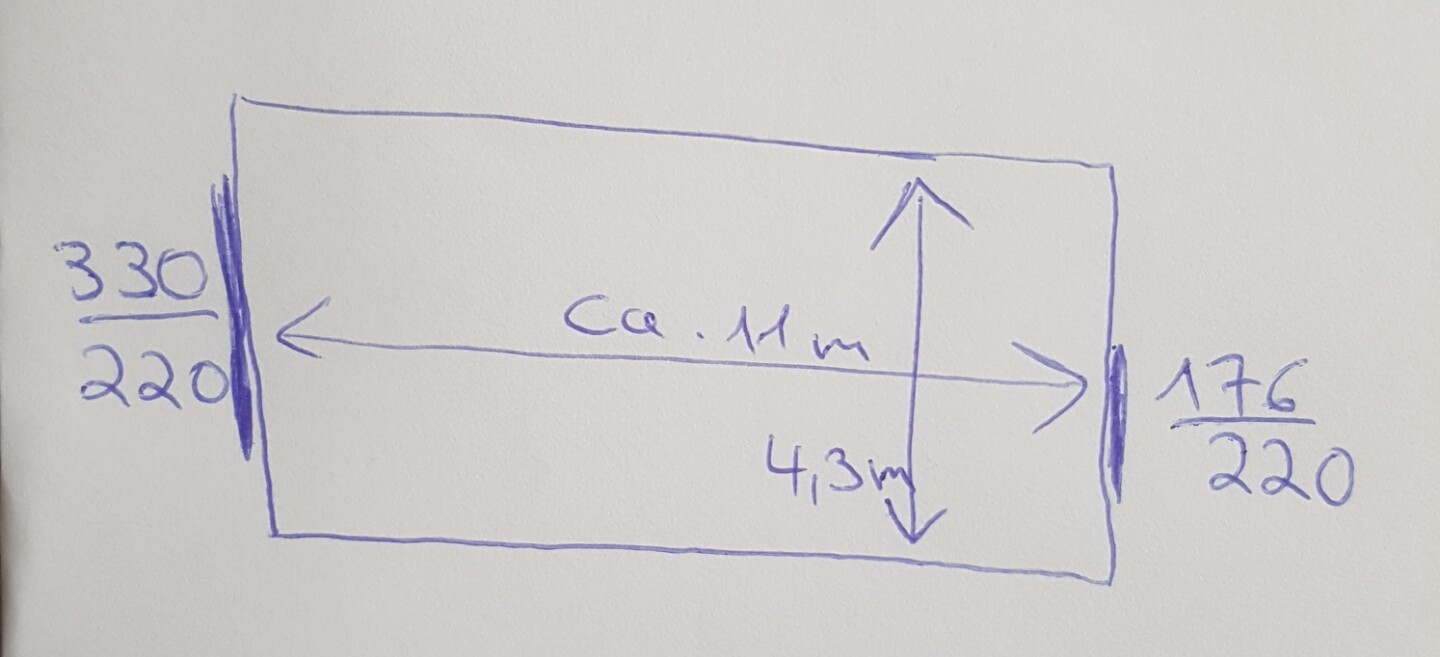

Attached is an example from the current apartment. It gets bright enough here. On the plan, left is west and right is east.
The only difference compared to the house is that the windows are opposite each other, but the total window dimensions are similar.
Can I use this as a reference point or not, because the windows face each other in the apartment?

Change the two 1m (3.3 feet) windows in the living room to 2m (6.6 feet) windows. This will enhance the important symmetry with the upper floor, provide plenty of natural light, and it doesn’t really matter whether the sofa is in front of a 1m or 2m window. I would also make all of them operable. Even if you don’t use them now, this might look completely different in 20 years, and maybe the sofa will face the window because TVs like today simply won’t exist anymore...
