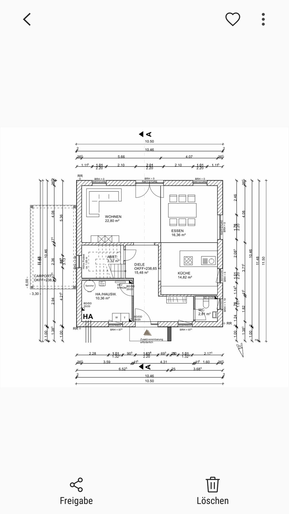

Shiny86
19 May 2020 12:31
It is at least 1 meter (3.3 feet) wide, and not far from that are the 2-meter (6.6 feet) terrace doors. So I’m not too worried about that. But I’ll see how it actually turns out...
If the central controlled mechanical ventilation system is installed in the floor, can I assume that I will have less ceiling height? What will happen to our 2.55-meter (8.4 feet) ceiling height then?
What do you think about the 151-centimeter (4.95 feet) wide passage from the entrance hall to the living room? I specifically planned it this way because I thought I could hang 20-centimeter (8-inch) deep Besta Ikea wall cabinets on the right wall in the hallway—between the kitchen door and the living room passage. I left 30 centimeters (12 inches) of space between the passage and the wall for that. But I’m not sure if I will actually put those cabinets up there (what really fits in cabinets only 20 centimeters (8 inches) deep?) and I’m uncertain if it will look good. How would you position the passage? It would also be possible to move it as far as possible to the right side of the plan. Would you take the windows into consideration when deciding on its location?
Alessandro
19 May 2020 13:36
Could you please keep posting the floor plan along with your questions? By now, it’s really difficult to keep navigating through all the pages.
Shiny86
19 May 2020 13:40
Alessandro schrieb:
Could you please keep posting the floor plan with all your questions? By now, it’s really difficult to keep navigating through the pages...
Sorry! Here it is
Floor plan of a house with living room, dining area, kitchen, hallway, storage room, and carport.
