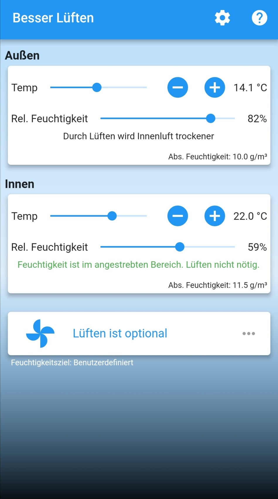

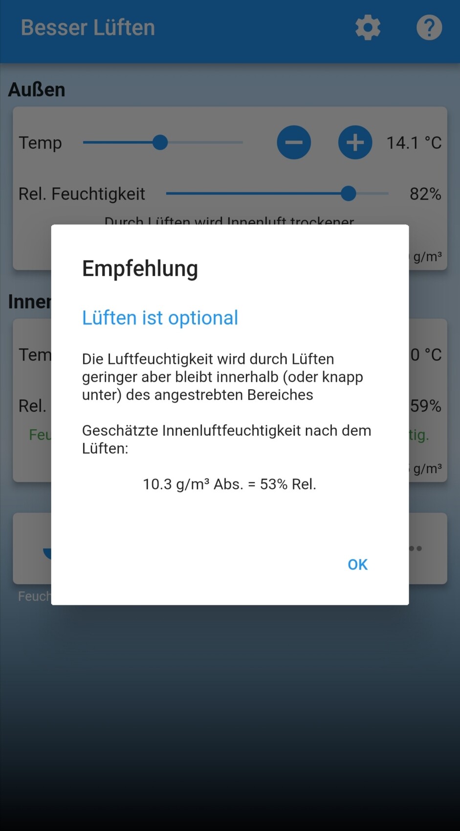

Download the app "better ventilation," it's self-explanatory. Unfortunately, I have iOS and it’s not available there. I downloaded a similar app. This clearly shows my problem again. Currently, it doesn’t get cold outside, not in the evening, morning, or night. On top of that, there is high humidity outside—so what should I do?
Keep the windows closed during the day. Still, try to air out the rooms early in the morning and in the evening. An outside temperature of 14°C (57°F) with 80 percent humidity is actually drier than 22°C (72°F) with 58 percent humidity inside. Ventilating will make the indoor air drier, even if that is hard to believe....
