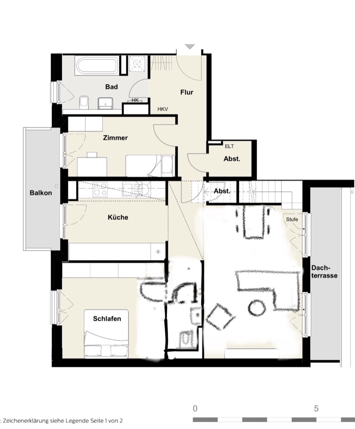

I would appreciate your feedback on the attached floor plan (not a house!).
I know this is a house building forum, but maybe someone still wants to help.
Since it is a new build, the floor plan can still be changed.
Where do you see needs or weaknesses in the floor plan?
Here are the changes I am considering:
- Change the shower bathroom to a guest toilet (see picture below), advantages: private access and more closet space behind the bedroom door possible
- Include a shower in the bathroom, possibly omitting the bathtub
The stairs behind the dining table lead to another roof terrace on top of the building.

This is a substitute.
Unfortunately, there has been no progress with the plot, so I have written it off.
But that’s a good point. What do you think about the apartment’s east-west orientation, especially regarding brightness?
The apartment is on the 6th floor.
Sofa arrangement:
I would have the door to the small roof terrace reversed so that it opens in the opposite direction.
Sofa arrangement:
No, the door is next to the sofa.
The table should not go under the stairs. That’s not possible anyway because there is a wall there.
The sofa measures 2.50m x 1.70m (Ikea dimensions).
The table in the drawing is 1.40m x 0.8m.
However, the table will be newly purchased as needed.
Distance to the TV is about 3m (10 feet) from the seating area.

Obstlerbaum14 Jan 2019 09:15The "roof terrace" is not practically usable, maybe only for a few kitchen herbs. A bedroom with evening sun, but the living area facing east? With this change, you wouldn’t have a single shower in the apartment – personally, I would prefer to remove the bathtub from the bathroom instead.
