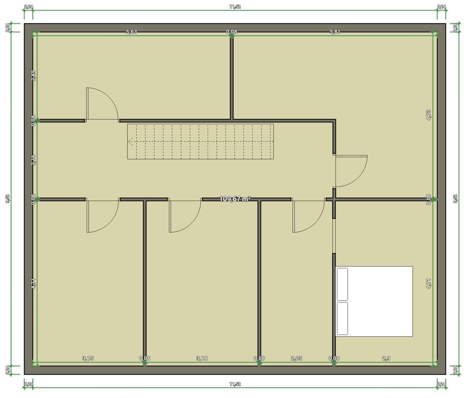

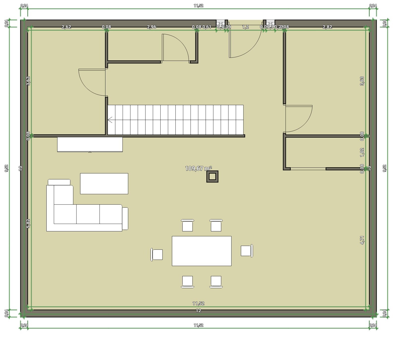

After countless drafts, we have now really fallen in love with this rough concept.
The plot offers a great view to the south.
So far the unknown factor is the neighbors’ development. We want to plan so that it does not really matter how they build without restricting us much.
Of course, we would like some basic suggestions about the floor plan.
Too small, too large, senselessly planned...
We have tried to create simple structures. We don't need any special frills.
The main living area will be the primary room.
Do you think the children’s room sizes are sufficient? How is the lighting there? The windows were just roughly drawn in. Should / must skylights still be added there?
Before we add all the furniture, we would like to know in advance if the basic planning could work.
We have already placed the little house (still with rotated ridge) on the plot.
We are already looking forward to an engaging discussion and are open to every suggestion.
Matthias
PS: Just noticed I forgot the window in the dressing room; of course, it will be added later.

please don’t be too harsh on me for the imprecise measurements. Unfortunately, it wasn’t possible to do better quickly on the tablet.
The drawn furniture pieces are to scale. (And that’s all we have at the moment.)
I hope the site plan clearly shows the ground floor with the attached garage.
PS:
Following some lively discussion, I’ve left out the windows this time....
And for everyone else, north is at the top!

May I ask on what basis you designed the walls the way you did? Was it just a rough estimate?
Malunga
15 May 2020 17:09
Yes Drasleona, I only created detailed measurements using this 3D software.
I have now downloaded an app for my tablet and basically traced the 3D version with my finger. It was really not easy to get precise measurements that way.
So, it’s more of an approximate estimate.
Drasleona
15 May 2020 17:14
I was also referring to the drawing in the 3D program.
I don’t understand why certain room sizes are chosen. You’re designing a 220 sqm (2,368 sq ft) house but insist that a 1.75 x 2.5 m (5.7 x 8.2 ft) sofa is sufficient. If the sofa really is enough, then why build such a large house? Do you like to dance the Viennese waltz?
I would really appreciate it if you could fully furnish the house virtually. That doesn’t mean you have to include every side table or the exact location of the dishwasher, but having basic furniture would be very helpful. Children’s rooms with a desk, bed, and wardrobe each. Bathrooms with a shower, sink, toilet, and possibly a bathtub. Walk-in closets with wardrobes. Etc.
