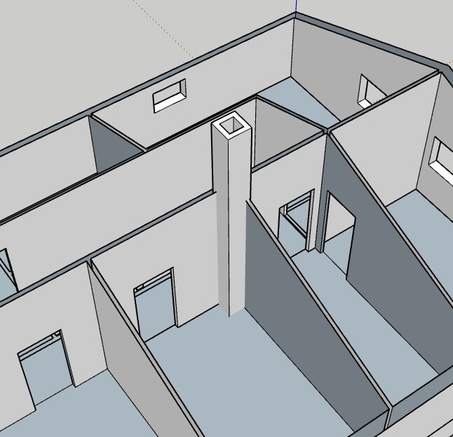

I can’t find a plot of land with 504m² (5,410 sq ft) on the site plan. Which one is yours?
Is that supposed to be a fireplace in the living room? Then the flue is missing on the upper floor.
Wardrobe: I thought the wall opposite the bathroom door was meant for the wardrobe and was already happy to see so much closet space fitting there. Is that not planned that way?
Edit: Oh, I see, the staircase is supposed to go there...
Pinky0301 schrieb:
I can’t find any plot on the site plan that measures 504m² (5,427 sq ft). Which one is yours?
Is that supposed to be a fireplace in the living room? Then the chimney shaft is missing on the upper floor.
Wardrobe: I thought the wall opposite the WC door was for the wardrobe and was already excited that so many linear meters of cabinets would fit there. Is that not planned?
Edit: Oh, the staircase is supposed to go there... Hello Pinky,
very observant, but as I already mentioned in the first thread, plot number 84 will be expanded to 504m² (5,427 sq ft).
Unfortunately, this is not yet shown in the current planning permission / building permit.
Yes, that is the fireplace; its prominent position in the living room resulted from the fact that we first designed the upper floor and then determined its location in the living room. I don’t find that a problem, as it will probably make for a nice focal point.
I’ve attached an image showing the chimney shaft on the upper floor.
Yes, the lines are supposed to represent a straight staircase. Unfortunately, I haven’t taken the time yet to draw the individual stringers.

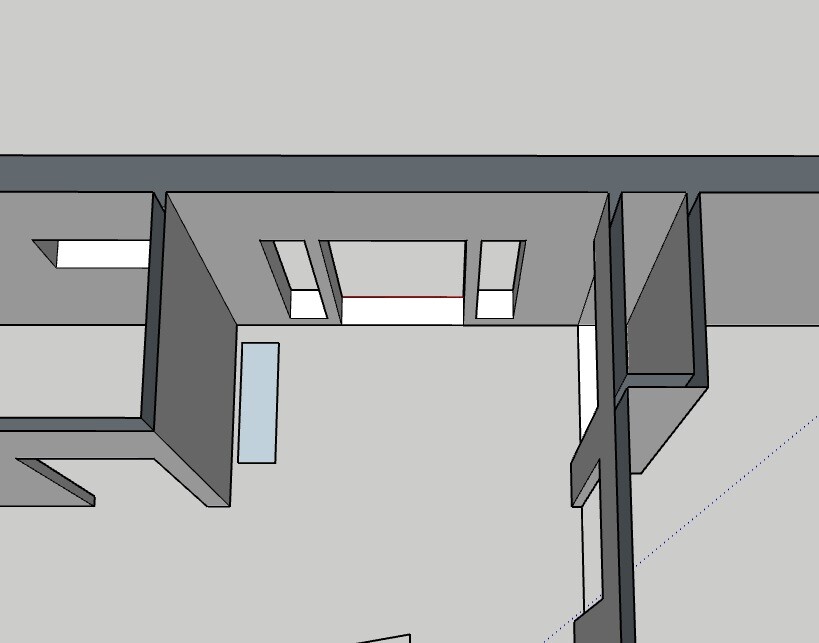

I’ve also added a kind of built-in wardrobe as well as two windows for natural light.

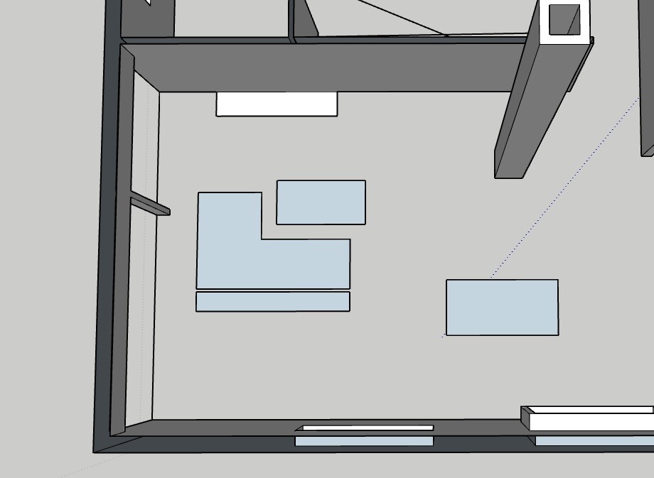

In the living room, I’ve now sketched in our current furniture at a 1:1 scale. I left out the chairs for now… maybe we’ll move the table around a few more times.
saralina8714 May 2020 15:10Can you do this with dimensions as well, preferably for the entire floor?
As it is, it’s difficult to assess, at least for me...
Alessandro14 May 2020 15:15What can be said, however, is that the wardrobe seems more suitable for the daughter’s dollhouse.
I would definitely recommend including the stove in the plans from the very beginning!
