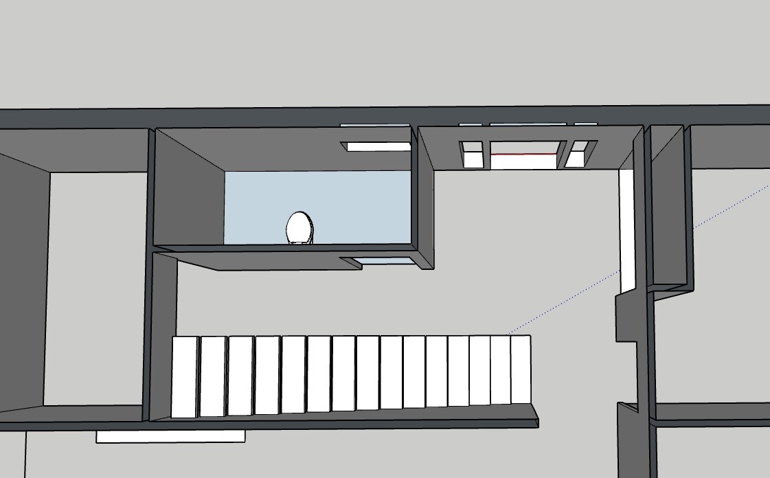

Well, if you like it, it can be a good idea, yes. However, you do lose a bit of the room’s spaciousness. Everyone has to decide for themselves what they want and what they don’t. Maybe the distance works perfectly for you, in which case that’s great Right now, when I measure, the distance from the end of the sofa to the front of the TV is 1.4m (4 feet 7 inches).
Our TV isn’t very big, and we don’t really need a larger one, so we can sit that “close” to it…
I’ve now added the staircase to the plan for better understanding
Malunga schrieb:
I’m already working on installing the steps...
It’s just a 3D program, not a floor plan software But what for? I was already able to read 2D paper plans back then. You would have needed about twenty floppy disks just to install a 3D drawing program on your 286 computer (and then the hard drive would be full, so you’d have to uninstall it again to do your tax return). Whether it’s a blessing that nowadays no one sketches anymore—I’m not so sure...
