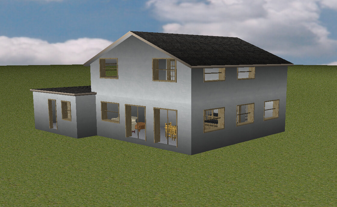

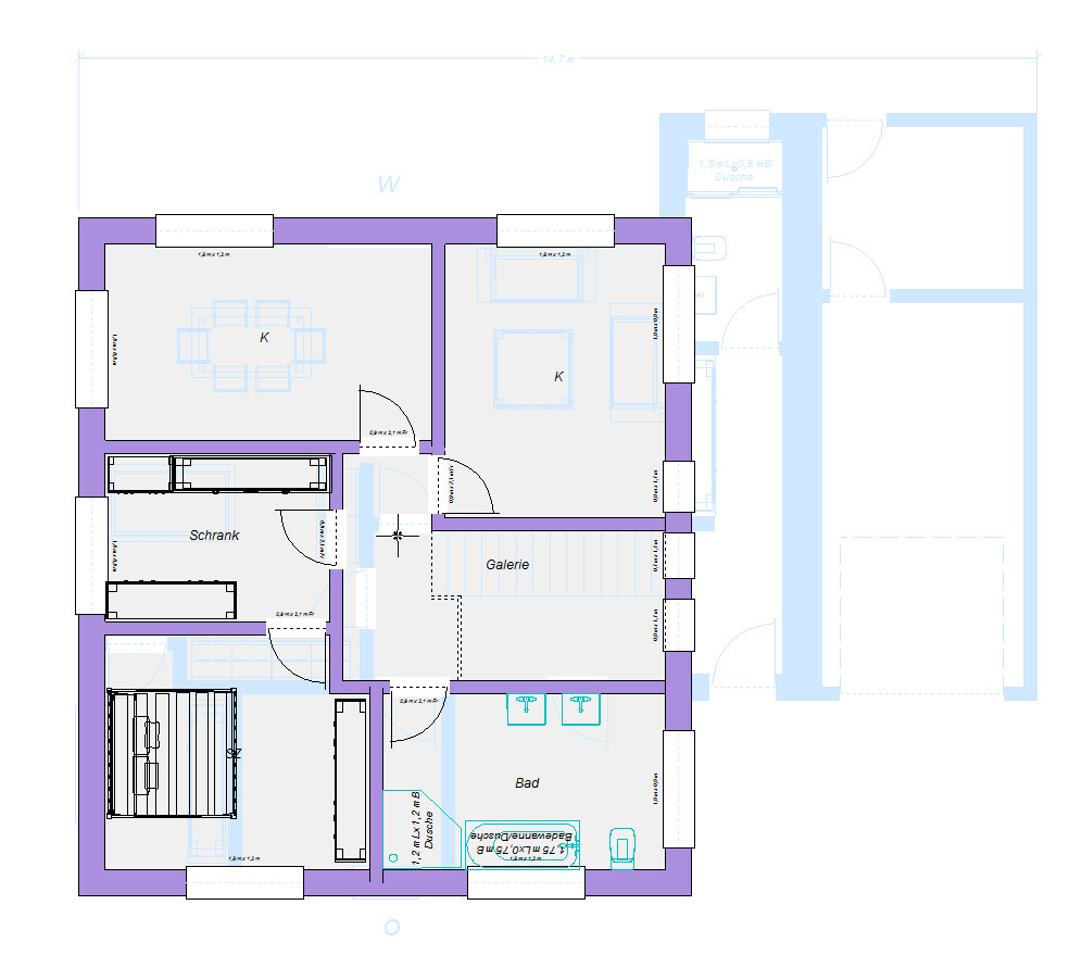

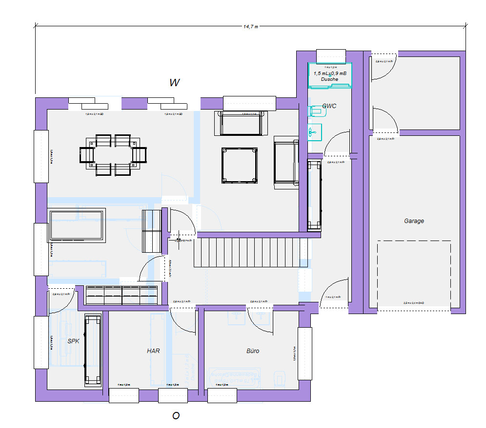

Maybe something like this?:
Floor plan of a house: kitchen, living and dining area, office, utility room, pantry, garage, stairs, doors.
Floor plan of a residential house with kitchen, bathroom, gallery, and closet.
Two-story house with pitched roof and attached garage on a green lot.
Two-story model house with extension; glass fronts open, interior visible.

face2616 May 2020 10:41
Now we’re heading in the right direction!
No one mentioned anything about airspace.
@kaho674 I really like your suggestion! I would personally swap the living room and kitchen, because I’d prefer to have the kitchen facing the garden and would be fine with the living room on the west side, but that’s a matter of personal taste.

kaho67416 May 2020 10:50
face26 schrieb:
Personally, I would swap the living room and kitchen, as I’d prefer to have the kitchen facing the garden and the living room on the west side, but that’s a matter of taste.

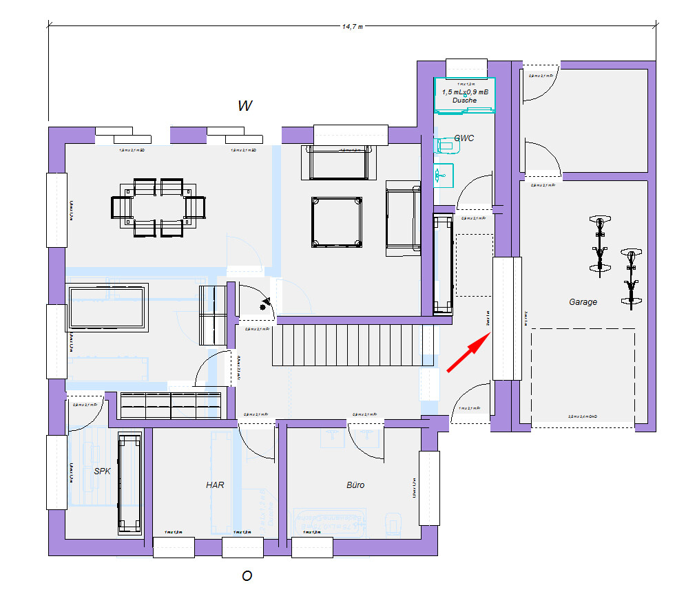

Yes, there are still options. If you’re real motorcycle enthusiasts, you could install a wide window in the hallway to view the bikes. That would be fun:
Floor plan of a house with garage, office, utility room, pantry, and shower; red arrow marks the entrance.

What about the entrance? It belongs to the building envelope, right?
Does the garage roof need to be insulated as well?
Definitely above the entrance. We have the same situation; one side is insulated, the other is not.
