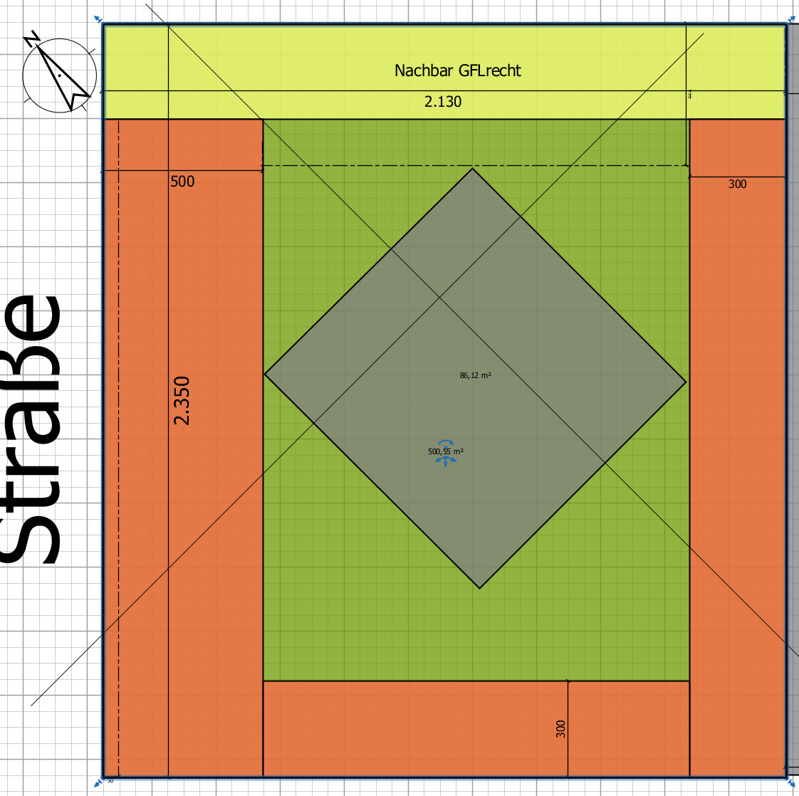

@ypg, Ah, I think I get it now. You mean I should position the entire house at an angle on the plot? So, not parallel to the street and plot boundaries, but diagonally?
That is indeed challenging given the building footprint and setback limits. I would definitely have to go for a square shape and would lose about 5 sqm (54 sq ft) of floor area.
I also don’t quite see yet what benefit this would bring in terms of lighting and such. The area north of the house would increase, which to me doesn’t really compensate for the slightly larger area on the west side, since that side always faces the street...

@ypg:
Thanks for the sketches, so I did understand you correctly after all.
I argue that it can work like this:
Whereas your suggestion, which is definitely a nice out-of-the-box idea, probably won’t work due to the area requirements.
