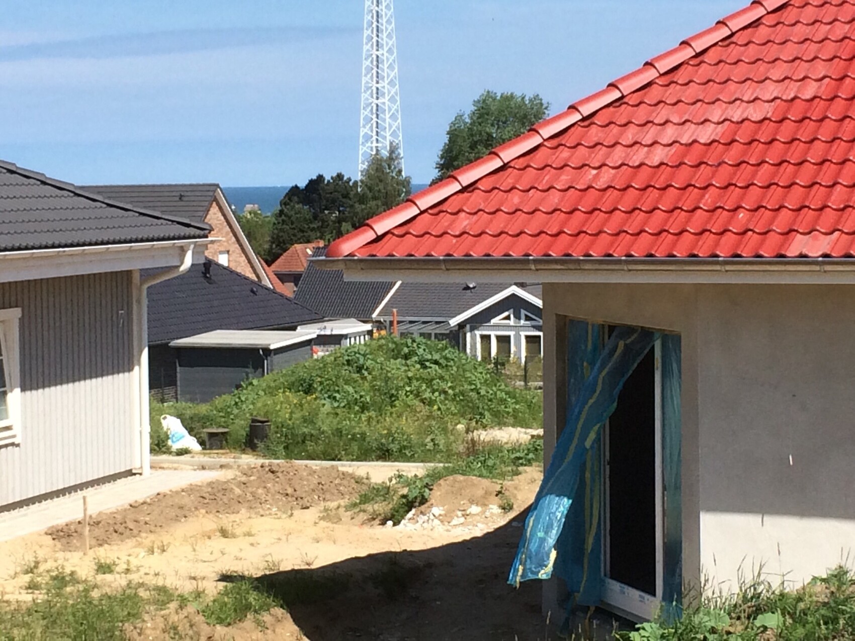

See example picture.

I see you now have an avatar picture. Is that the inspiring basic type (119 or 146)?
Expanded clay aggregate is fine; some companies build with masonry, others with wall panels – that could explain the unusual dimensions.
