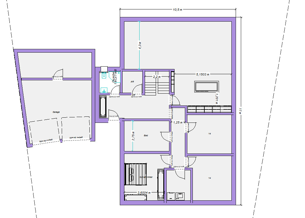

Maybe this is an approach?
kbt09 schrieb:
I continued with the approach from the floor plan adjustments.
Architect’s floor plan of a single-family house with living room, kitchen, bedroom, and bathroom.
Floor plan of a building on a plot as architectural drawing
Now to the main topic.
At the end of April 2019, we reserved a plot (plot no. 10) and started working on the floor plan. The plot is tied to the developer, and unfortunately, the planner has not turned out to be very creative (myself included). Two weeks ago, we had another meeting with the developer and talked about the three options mentioned above. We then chose one variant and want to proceed with it. We have now received a draft, which certainly still needs improvement.
For this reason, I would like to present the floor plan here again for discussion and hope for feedback, ideas, suggestions, and tips. Maybe you will immediately see things that “just don’t work” or are not practical for everyday life. I have also already noticed a few things that I would change, but since we will probably make quite a few modifications anyway, I have not yet suggested my own improvements in the floor plan. Also, the planner and I have not yet discussed doors and windows.

-The main bathroom is located between both children’s rooms and the noise from showering and toilet use is likely to be a major issue
-The main bathroom could be slightly larger
-Between the garage and the property boundary there will be a dead space where weeds will probably grow later. Does anyone have ideas on how to prevent this?
-The garage is currently planned with a length of 9m (30 ft), of which 6m (20 ft) is for the garage and 3m (10 ft) for a storage room. The current position directly behind the garage is not optimal in my view

The main bathroom is located between the children’s rooms. How can we reduce noise disturbance to a minimum?

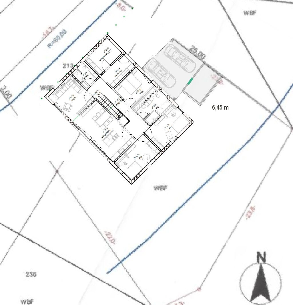

Imagine I drive a Skoda Superb into the garage. Since the garage is on the property boundary and the driveway narrows between the house and property line, I have to enter at a slight angle. Does this cause problems in everyday life? See pictures.
Assuming we build a double garage directly attached to the bungalow instead of a garage and carport, is there anything special to consider during construction?

As you can see, the house then has to be moved quite a bit forward.
Logically, it would make more sense to move it further back since you are extending diagonally and the southwest corner is approaching the boundary area.

He probably meant the back, this time he just had the site plan upside down.
Now, something completely different. The kids’ rooms are on the sunny side, so now definitely quiet. The terrace might be a bit problematic, but the afternoon/evening terrace depends somewhat on the neighbor’s plans anyway due to sunlight.

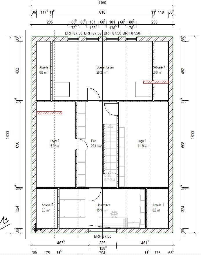

While designing together with the attic, I thought of various possible future use scenarios.
  • From the kids’ rooms, add a second level accessible by a space-saving staircase/ladder, and separate a playroom upstairs, creating two larger units for the kids. Or without a staircase in the room, simply a second kids’ room.
  • Set up a living unit upstairs for a caregiver living in the house (accidents, illness, etc. might make this necessary).
  • Separate a living unit for a child: just close the living room door downstairs, add an extra door by the staircase in the hallway, so parents have their own area downstairs and the child can develop an apartment upstairs (which is why there are two red boxes in the attic to provide water there).

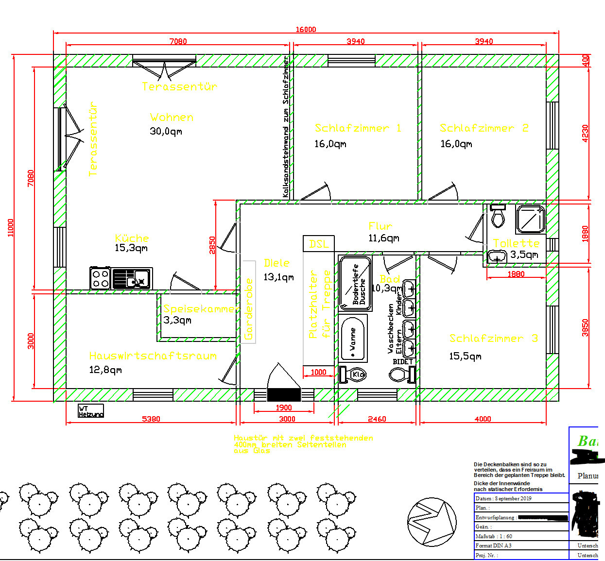

In your floor plan, I find the living room very small.
Again: the living room is only separated from the rest of the living and dining area. It measures 4x4m (13x13 feet), and if that is too small for the lounge area, just remove the partition wall – then you have a generous approximately 59m² (635 sq ft). But I don’t want to dwell on that – you don’t like the layout anyway. I’m just saying this because for you something like this

15 Aug 2019 11:28
Chrisi1906 wrote:
I find the living room in your floor plan very small.
Then just remove the reduction there and straighten the wall. What’s the problem? This is not a suggestion that can’t be changed. The idea is what counts, the possibilities.
