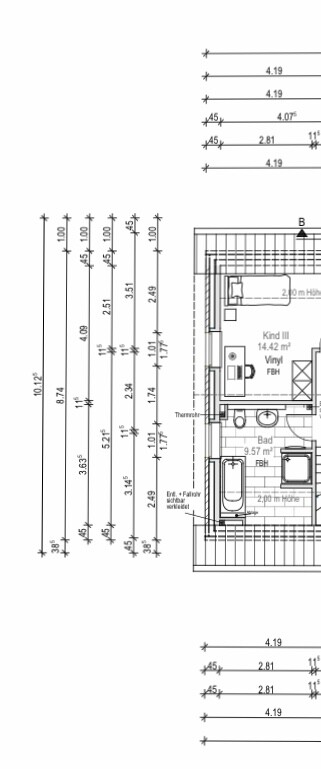

attached is the layout of our bathroom on the upper floor for discussion. Thank you.

kati133718 Aug 2020 23:00
zr10r schrieb:
Attached is the plan for our bathroom upstairs for discussion. Thank you
This looks remarkably similar to our bathroom. Both the plan and the layout of the floor plan.
Is this also from T&M?
Ours is a bit larger, and the bathtub is installed at an angle. Otherwise, it's almost identical.

zr10r schrieb:
attached is the planning of our bathroom on the upper floor for discussion. Thank you
For less than 10m² (108 sq ft), you really made the most out of it.
Is a double sink not an option for you? For us, that would be an absolute priority. A tiled shower will probably be difficult given the size of the bathroom, but it’s not a must. I actually think the bathroom looks quite nice.

Is it possible to position the bathtub so that you can look out of the window while bathing? Would the person bathing then be able to see some sky or greenery?

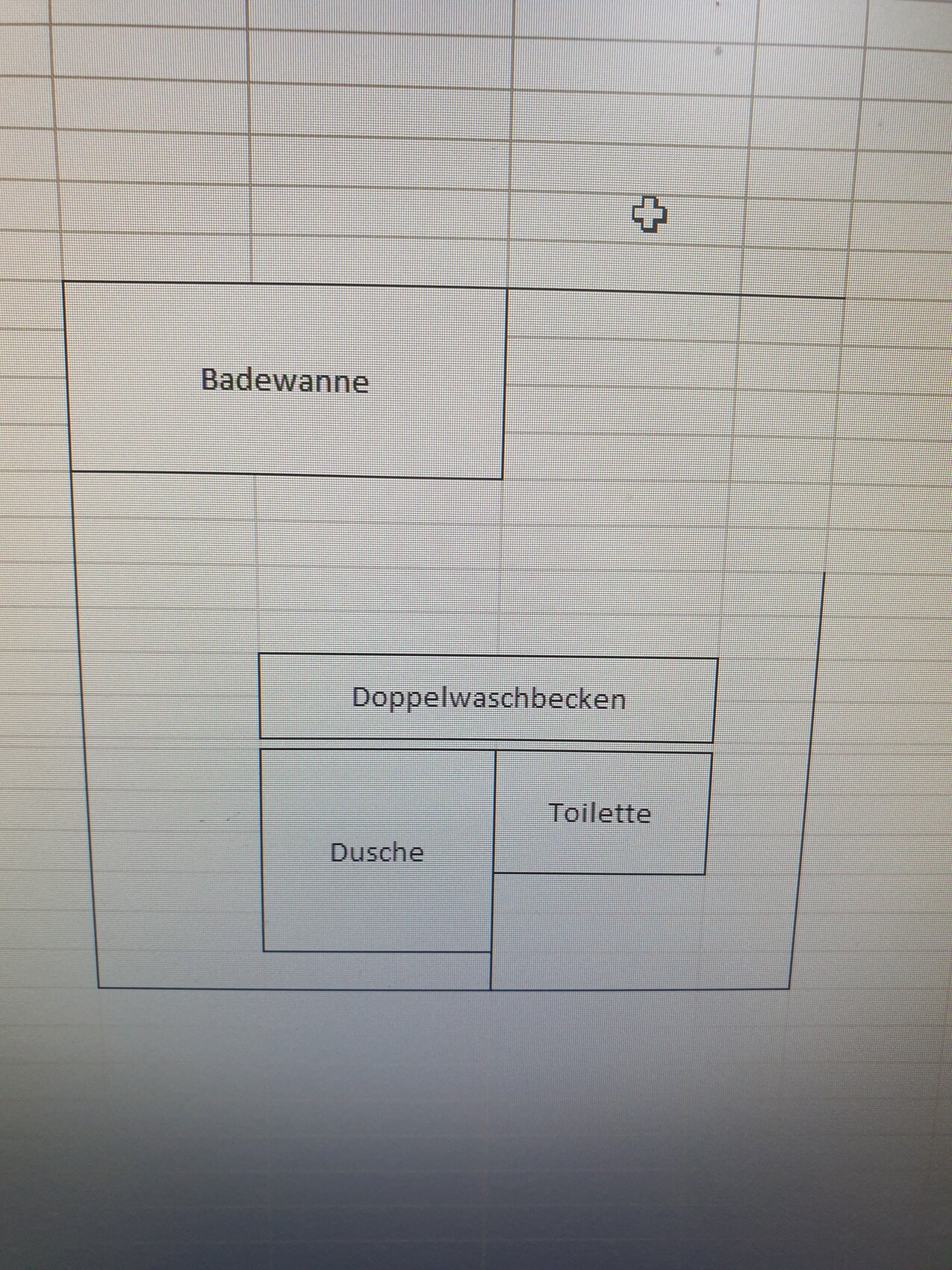

Have you already tested with a T-wall? Place it at the bottom. Behind it, there will be a tiled shower and a toilet on the other side. I made a rough sketch.
Our bathroom will be about the same size.
