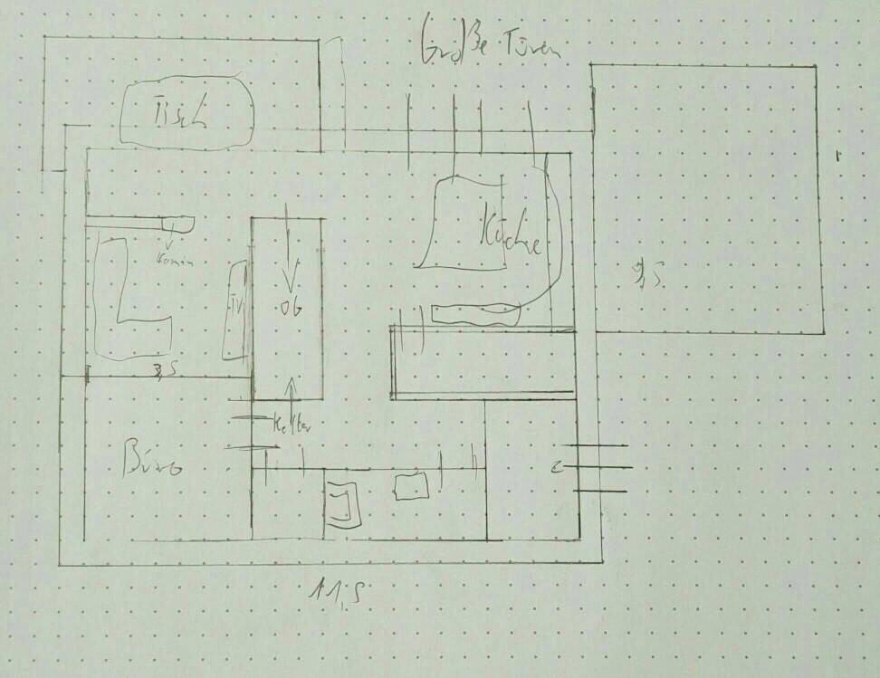

Hello, I just had to quickly jot down an idea that’s been on my mind for days...
Why not simply use the staircase as a room divider?
What are the potential advantages and disadvantages of this?

A straight staircase requires quite a bit of space. This might not be as noticeable on the ground floor if an open floor plan is desired. However, on the upper floor, it becomes more challenging to provide good access to all rooms (though it can work well!).
One factor that ruled out options for us was the location of the stairs when you want a basement: either the basement stairs start from the living area, or the staircase leads directly to the upper floor. Neither was acceptable for us.
That’s why it’s best to consider all floors together—otherwise, you might fall in love with one level only to later realize in dismay that another level doesn’t work at all.
8 Jun 2017 22:27
By room divider, you do not mean a load-bearing wall, correct?
In your drawing, you would be able to see from the sofa, between the stair treads, directly to the kitchen stove. This might not be an issue in other floor plans, but not everyone appreciates the visual distraction of the staircase behind them. Additionally, the living room would not be quiet if other family members (especially children) use the stairs multiple times in the evening with friends.
In your example, the TV equipment would be exposed at the back, and dust would fall onto the TV through the open stairs — making it harder to concentrate on the TV.
By the way, an open staircase can also cause structural challenges, as the floor above the ground level still needs to be supported somehow.
With load-bearing wall sections, however, a staircase can always be used positively as a room divider — although this may not suit every lifestyle or family situation.
