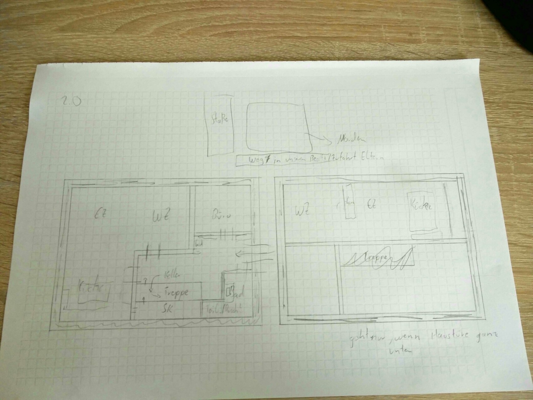

New attempt. I tried to avoid the mistakes from version 1.
The pantry is now in the northeast, the bathroom can have a window, and I have a staircase leading down to the basement. Only the kitchen is quite far from the entrance.
What probably won’t work is the connection to the garage. Otherwise, I won’t get a yard that’s large enough because I have to move the garage so far forward.

The pantry is 1 meter (3 feet 3 inches), right? That’s too narrow. Unfortunately, I’m not at my computer right now, so I can’t provide a link. In terms of style and layout, it’s similar to our floor plan. You could try looking it up. There’s also an interesting discussion about the size of the pantry [emoji6]

I noticed that too. That's why the small arrows point upwards at the staircase and pantry.

You can't clearly see a sheet of paper photographed at an angle. It's better to take the photo from above; even better would be to scan it.

Don’t waste space in the guest restroom. Move the wall up to the top of the staircase landing. Karsten
