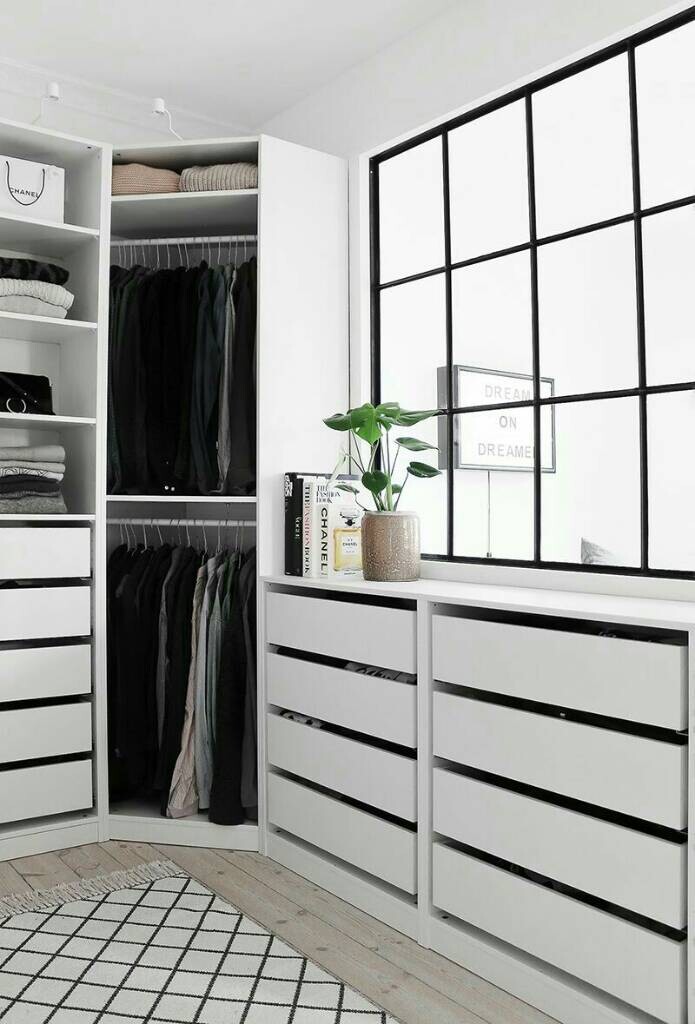

The only question is how to solve the walk-in closet issue? I haven’t fully understood the problem yet. If you want a window there, just put it in. Nowadays, closets can be custom-built. The laundry chute could easily be placed on any other side of the room. It might be worth considering integrating the chute into a closet right away. That way, it’s visually hidden, and the space above can be used as storage.M
MIA_SAN_MIA__1 Dec 2017 17:29kaho674 schrieb:
I haven’t fully understood the problem yet. If you want a window there, just install it. Nowadays, wardrobes can be custom-made easily. The laundry chute could also be placed on any other side of the room without any issues. It might be worth considering integrating the chute directly into a wardrobe. That way, it’s visually hidden and the space above can be used as storage.Maybe like this. I need to experiment with the Pax configurator. Perhaps then I’ll find the solution.Source: homedeco
