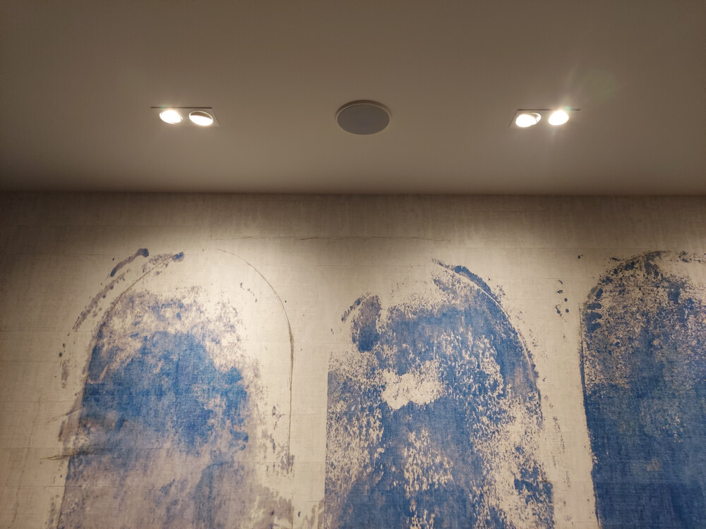

Yes.
1.) The access point is on the ground floor.
2.) The access point is on the upper floor. The cover grill will be screwed in tomorrow.
I have also prepared additional network cables for more access points.
However, it seems that these two, together with the FritzBox in the utility room, are sufficient.
If you like the design and the performance is sufficient, then everything is fine.
For me, with technical devices like these, performance is more important than appearance. The 2.4GHz network will have a long range, but your installation won’t be beneficial for the 5GHz band.
