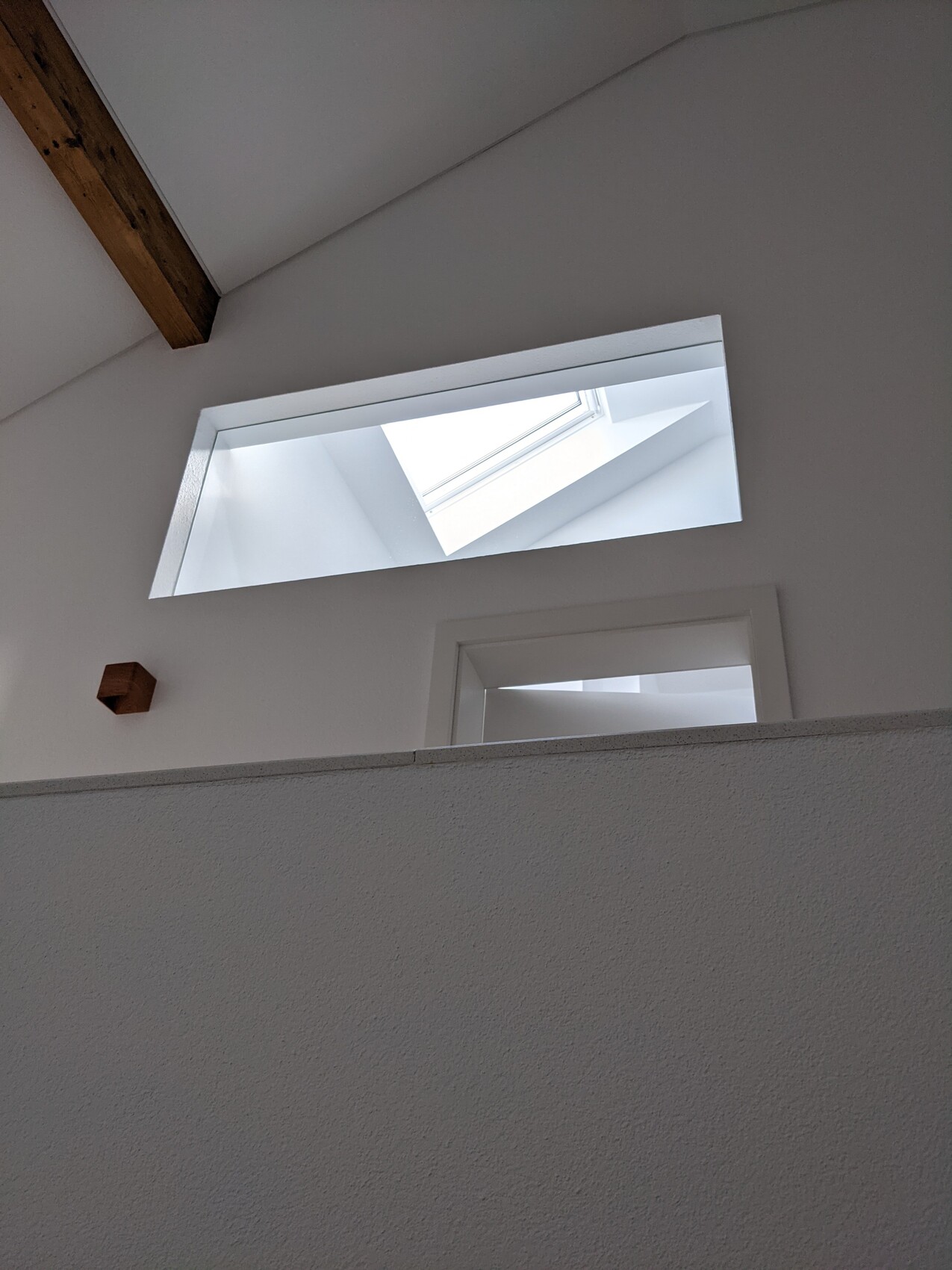

We also have an interior hallway, and in the bathroom there is a roof window, as it was not possible to have a side window (terraced house). Our architect suggested making use of the light and planned a skylight in the bathroom. Looking back, I’m very glad, as it fits well with the orientation and makes the hallway feel bright throughout the day.
This is how it looks from the stairs
