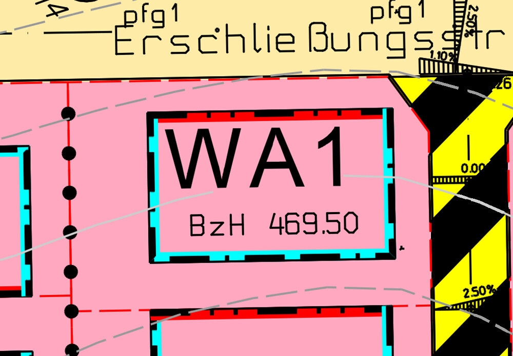

Hello everyone, we have the possibility to purchase a plot of land for a linked house and are currently working on initial floor plan ideas. The plot is 14.5 m (14.5 meters) wide and 22.5 m (22.5 meters) long, and as far as we understand, a 3 m (3 meters) wide garage must be built on the left side. On the right side, our plot borders the street, so there is a setback requirement of 2.5 m (2.5 meters).
I’m attaching my current floor plans and the site development plan (plot marked) and would be happy to hear your opinions. Thank you in advance.

BruckHaus26 Mar 2021 09:35Thank you for your comments, I have now completed the questionnaire:
Development Plan/Restrictions
Plot size: 323 sqm (approximately 3,476 sq ft)
Slope: no slope, flat plot
Site occupancy index: 0.6
Floor area ratio: 2 full floors
Building envelope, building line and boundary: see development plan
Edge development
Number of parking spaces: 1.5
Number of floors: 2
Roof type: shallow pitched roof
Architectural style: modern, Bauhaus
Orientation: -
Maximum heights/limits: ridge height max 7.20 m (23.6 ft), eaves height max 6.50 m (21.3 ft), eaves height min 6.00 m (19.7 ft)
Other requirements: building method A1 terraced house
Style, roof type, building type: green flat roof specified, modern style, with large windows
Basement, floors: basement planned with 2 full floors
Number of residents, age: 3 people (34, 31, 9 months)
Room requirements on ground floor and upper floor: on ground floor kitchen, living and dining areas and an additional office (does not need to be large, for a home office space)
Office: family use or home office? Home office space
Overnight guests per year: none
Open or closed architecture: open architecture
Conservative or modern construction: modern construction
Open kitchen, kitchen island: open kitchen
Number of dining seats: 4–6 seats
Fireplace: no
Music/sound system wall: integrated into the TV wall
Balcony, roof terrace: balcony planned above the living room extension, access via the children's room
Garage, carport: as this is a terraced house, the garage/carport connects to the neighboring house. We are currently inquiring with the municipality whether it will be a carport or garage. It must be at least 3 m (9.8 ft) wide.
Utility garden, greenhouse: garden with lawn and hedge.
Additional wishes/special features/daily routine, including reasons why some things are included or excluded: No major special features. We don’t need a bathtub because none of us really take baths. Instead, we have planned a larger shower measuring 90 x 120 cm (35 x 47 inches) and prefer two sinks, or one large sink. Since our family life mainly takes place in the living/dining area and kitchen, these rooms should be bright and pleasant.
Who designed the plan: we have so far planned ourselves and combined the best from several layouts. Our current furniture is already included in the plan and will be moved into the new home.
What do you particularly like? Why? Bright, open living and dining area with garden access. We like it bright and friendly.
What do you dislike? Why? The bathroom is not yet optimal; a different layout would be better.
Price estimate according to architect/planner: currently around €450,000
Personal price limit for house including fittings: estimate is still within budget
If you have to give up, which details/extensions
-can you give up: loggia
-can you not give up: basement
We combined ideas from several layouts. In the upstairs hallway there is a general space for a piano or a second desk. The open living-dining area with kitchen is a must for us. Also, the kitchen must have a window to look outside. We have a very large closet in the hallway to store items like coats and vacuum cleaner. The bathroom layout is currently not optimal in our view.
We have to design a terraced house but are last in the row, so only one side adjoins a neighbor, the other side borders the street. We need ideas and experience regarding terraced houses—what must be considered for the floor plan in this case?

Nice-Nofret26 Mar 2021 10:03Have someone calculate how much more it would cost to fully build over the living room bay window. That could help reduce the load on the sleeping floor a bit.
