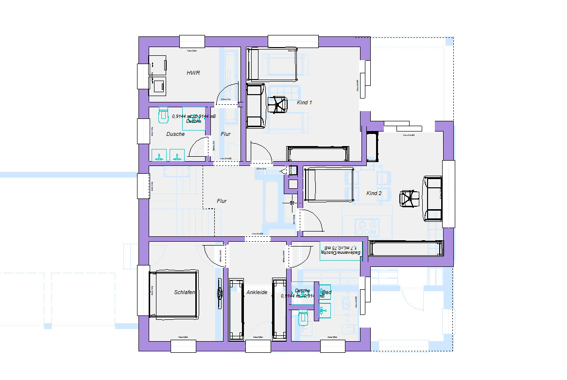

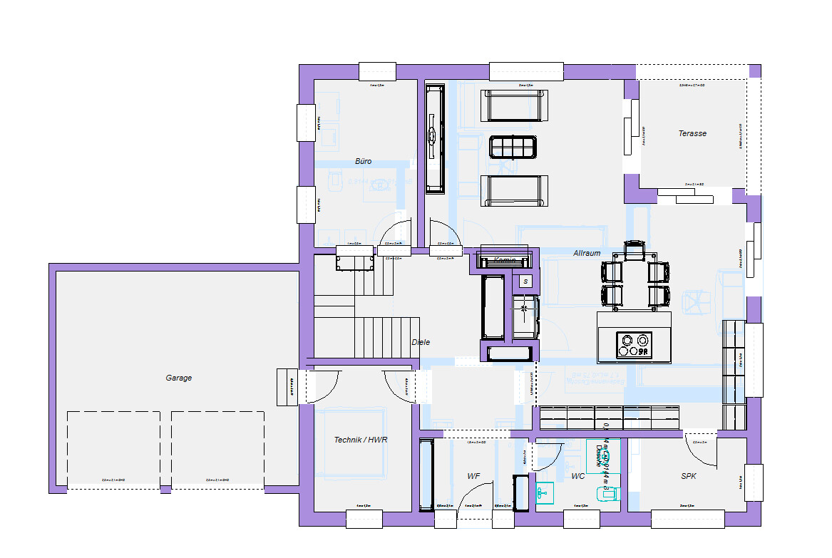

Hello, I need your advice on how to create a better layout for the master bathroom – utility room – children’s bathroom area.
Requirements:
Children’s bedrooms are on the south side.
The children’s bedrooms should be approximately the same size. The utility room should accommodate a dryer and washing machine since we are building without a basement.
Thank you for your help.
Requirements:

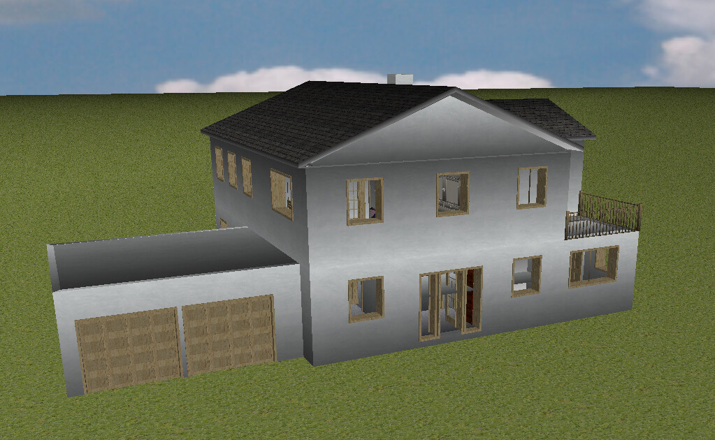

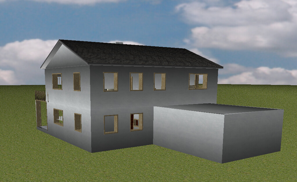

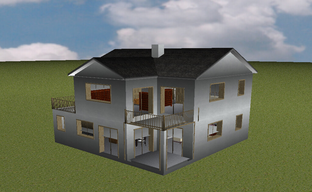

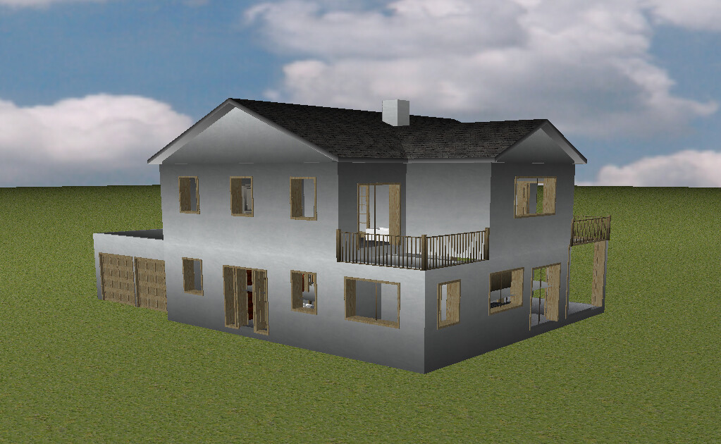

Gambling addiction. Hopefully only at an early stage. On one hand, I do like your demonstration of how a similar design would look with a non-central staircase. However, as a building, it appears to me as if a T-shaped bungalow has been combined with a basement that does not really fit it.https://www.instagram.com/11antgmxde/
Yes, the real experimentation started with a flat roof and only one balcony. This is the simplified gable roof version. It probably spoils the overall appearance. I really think it’s a shame that the 12.49 x 12.49 meters (41 x 41 feet) footprint now has to be squeezed under a gable roof.
I’m all for a really grand villa.
