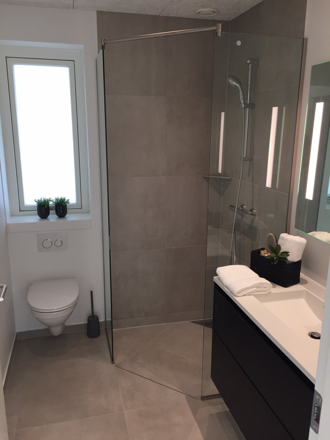

Hi, didn’t someone here say that you can’t install a walk-in shower in less than 8 sqm (86 sq ft)?
The main bathroom here is 3.9 sqm (42 sq ft)
The largest is 6.5 sqm (70 sq ft)
That was me, and the photos confirm it. They show two glass enclosures. To me, “walk-in” means something different.
Also, with such a shallow depth, there’s likely to be quite a bit of water splashing out.
