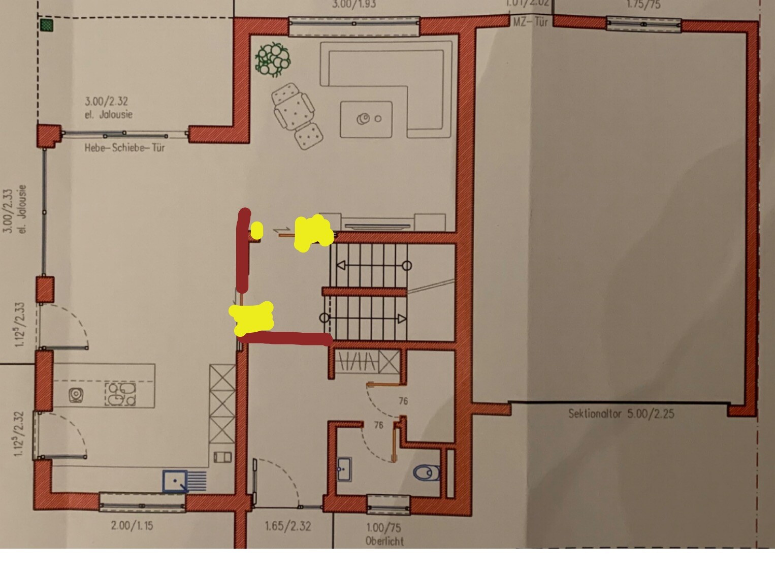

I completely agree with you.
I would shorten the hallway and partially separate it with a short freestanding wall (for example, exactly where the opening between the dining and living areas is now or in front of the basement stairs).
Phew... You just created quite a bit of confusion in my mind. Could you visualize that? I don’t quite understand yet. ‍
13 Nov 2019 22:03
Notstrom schrieb:
Phew... You just caused quite a confusion in my mind. Could you visualize that? I don’t quite understand yet ‍
Shorten the hallway up to the stairs -> stairs included within the open living space.
Wall panel about 1 meter (3 feet) wide positioned somewhere, either as a design feature or as a privacy screen in front of the basement stairs… it can’t be that confusing.
Notstrom
13 Nov 2019 22:10
Shorten the hallway up to the stairs -> integrate the stairs into the open-plan area.
A wall panel about 1 meter (3 ft) wide placed somewhere, either as a design element or as a screen in front of the basement stairs... it can’t be that confusing
...like this?

13 Nov 2019 22:29
Yes, something like that
Floor plan of an apartment: kitchen on the left, living room at the top, staircase in the middle, red walls, yellow markings.
