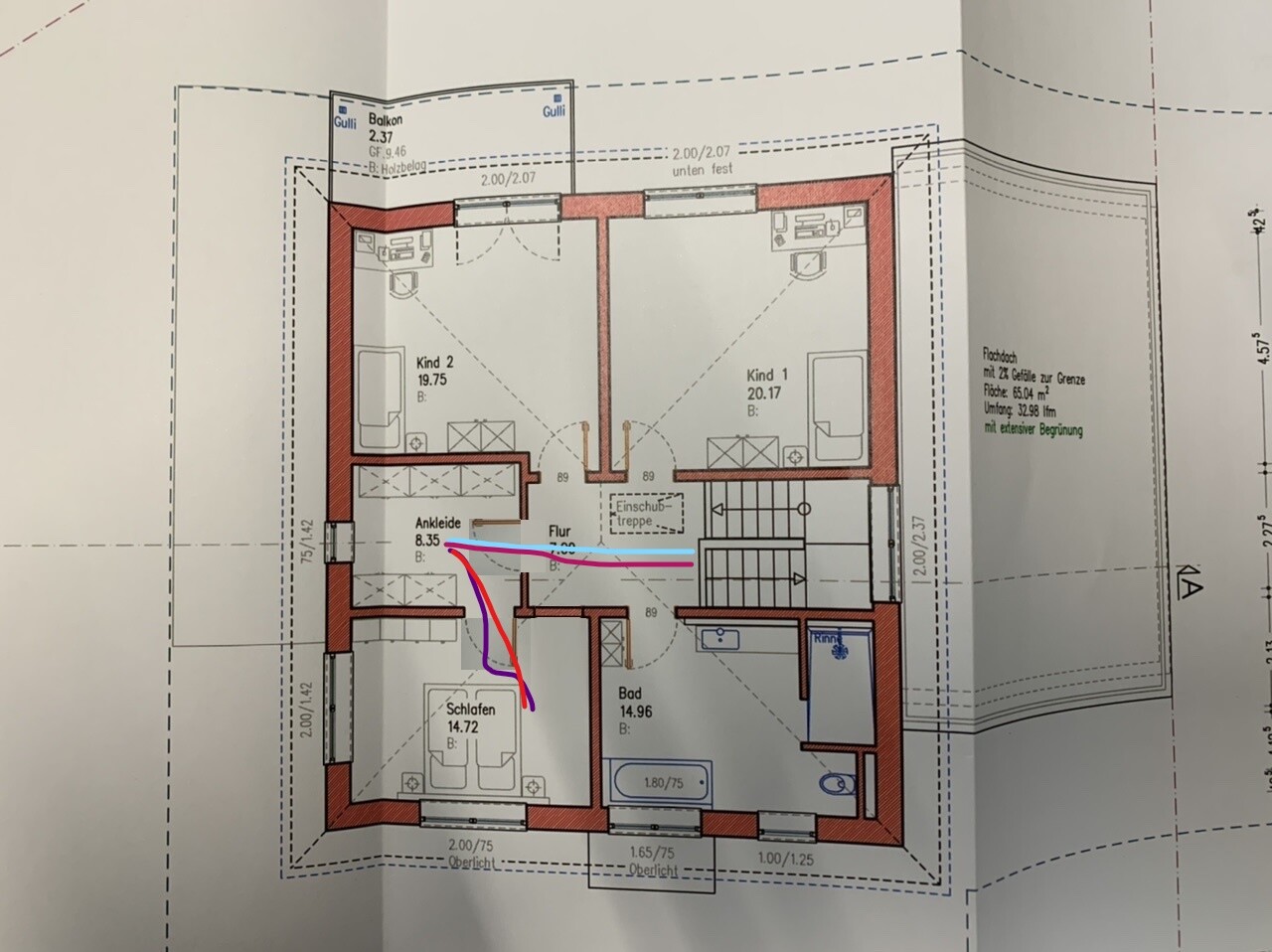

Upper floor plan:
Floor plan of an upper floor: hallway, bathroom, bedroom, child 1, child 2, walk-in closet

I would personally move the kitchen door closer to the entrance, prefer to have only one door in the bedroom, and swap the bathtub and the sink in the bathroom. I would place the sink on the wall next to the bedroom and extend it nicely.

Why don’t you access the bedroom through the walk-in closet? That would be much more practical...

I like the ground floor as it is, but for the upper floor, I would actually consider giving the second child some balcony space as well. That could cause some issues, though—if a second child is even planned and the room isn’t being used for something else.
I would swap the sink and bathtub because of the natural light. Having light at the washbasin is really practical and more necessary than near the bathtub. Access to the walk-in closet has already been mentioned—I would prefer that over going through the bedroom, but I guess that’s a matter of personal taste. Otherwise, I really like the overall layout.

Personally, I find accessing the space through the walk-in closet rather impractical and would have done it the same way as the original poster. I also quite like the room layout and sizes on the upper floor. However, as already mentioned several times, I would have preferred to keep the hallway open on the ground floor if possible.

So, the walking routes have been roughly marked for both layouts:
blue = coming in at night
purple = getting into bed after undressing
red = getting clothes in the morning
pink = leaving in the morning
I hope the routes are clear and that you can see how often you might disturb a partner who is still sleeping in one layout compared to the other
Floor plan of an upper floor with bedroom, child 1, child 2, walk-in closet, hallway, and bathroom.
Floor plan of a house with two children’s rooms, bedroom, walk-in closet, hallway, and bathroom.

It's a pity that you are now going ahead with the walk-in closet... Was our input here not clear, or is it a conscious decision regardless of any arguments? In that case, there's no need to discuss it further.
