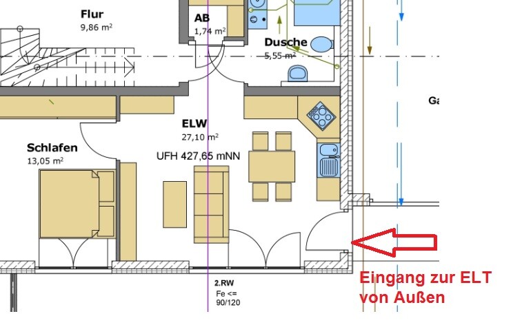

Could it be that you missed the entrance to the granny flat?
So this might not be necessary—if I understand you correctly.
Here is a picture with markings.

Is the entrance meant seriously? I had thought of it more as a patio door, a secondary entrance, or for smokers.
How is it supposed to work — key in the lock, open the door, take a step inside, and then straight onto the sofa? What about wet clothes and dirty shoes — everything dripping onto and dirtying the hardwood or carpeted floor? I take off my jacket in the kitchen.
And then: the jacket ends up on the kitchen counter and the shoes start to smell in the kitchen?
Admit it, this isn’t very practical. Somehow it might work for students and the like, but it could be done differently! There is already a small hallway with a wardrobe (the utility room), so it should be used as such and from there access to the separate apartment should be provided.
Scout schrieb:
Is the entrance really meant to be the main one? I had thought of it more as a patio door, or a secondary entrance for smokers.
How is it supposed to work, putting the key in the lock, opening the door, taking one step inside, and then immediately onto the couch? What about wet clothes and dirty shoes—everything dripping and dirtying the parquet or carpet? I take off my jacket in the kitchen.
And then what happens next: the jacket ends up on the kitchen counter and the shoes start to smell in the kitchen?
Admit it, that isn’t very practical. Somehow it might work for students or similar, but it could be done differently! There is already a small hallway with a cloakroom (the AR), so it should be used as such, and from there the separate apartment should be accessed. You are absolutely right. I hadn’t thought about that!
Thank you very much, Scout, for the suggestion!
