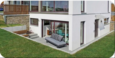

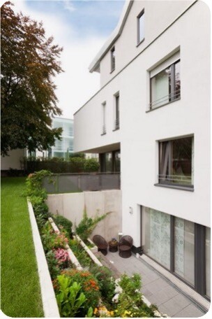

- Why basement? To maximize garden space, add storage area, and supposedly take advantage of the slope

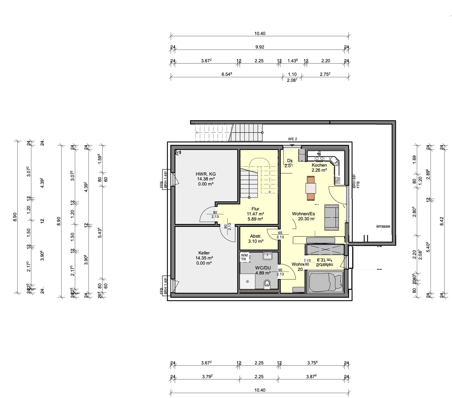

- Basement apartment
- Separate entrance to basement apartment
- Lift-and-slide door
- Maximize southwest garden area
- Partially covered terrace
- View axis from hallway to garden
- Daylight in walk-in closet
- External access to basement

- Garage not directly attached to house due to access to separate apartment
- Separate apartment quite complex

- This is the second iteration; earlier option had flat roof dormer with southwest children’s room, which we discarded; roof pitch probably 25° now
Which wishes did the architect implement?
- Most of them, but not all possible
What do you think about it, especially focusing on current pain points:
- Actually, our space requirements are smaller, but we cannot fit that on the ground floor to align with upstairs (difference about 10-15 m2 (110-160 sq ft)); kids’ rooms and circulation spaces including landing could be smaller
- Window area not yet optimal in living/dining, office, and large upstairs living area; considering 1.10m (3.6 ft) fixed glazing and 2.50m (8.2 ft) lift-and-slide door
- House feels somewhat "buried"; considering raising overall or at least GF + UF by 40-80cm (16-32 inches) above ground level
- The whole topic of “house/garage connection,” earthworks, and plot landscaping is very complex and time-consuming
- No external blinds (raffstores) possible on landing due to knee wall and roof
- Separate “dirty corridor” and staircase; could be a minor disadvantage for aging, might make separate UF rental impossible in future
Due to the maximum number of attachments allowed, we couldn’t add an aerial photo of the tree cover. There are three large deciduous trees directly to the southeast and on the southwest side about two chestnut trees and around 15 pines from the 1950s. We have no worries about summer heat protection 😉 – on the contrary: enlarging the house footprint would cost us garden and especially daylight.
Feel free to ask any questions.
We look forward to your feedback and thank you in advance.

nordanney29 Dec 2024 13:33Such a granny flat is only worthwhile if you are located near a university or actually building in or very close to a major city. Otherwise, it will always remain a pure burden for family use, as it is hardly rentable to outsiders.
From a tax perspective, it only makes sense if you are already quite old. Once the depreciation allowance (AfA) is fully used, it hardly pays off anymore—unless you are approaching retirement and no longer need deductible expenses. Considering the combination of the apartment’s quality and the cost-benefit ratio (tax-wise), I would actually find it too expensive.
SoL schrieb:
Well, giving only 6m² (65 sq ft) of bedroom space to the older person in a 200m² (2,150 sq ft) home is… borderline. Take a few square meters from the living room of the granny flat. Fair point. Why did we plan it differently so far? The bedroom was really intended just for sleeping, maximizing the space in the living room and kitchen, also considering the lighting.
I can’t contribute anything about the planning phases.
Regarding the floor plan: there are no major flaws. Personally, I’m not a fan of a long, narrow pantry. I would rather skip the pantry and design the kitchen more generously and comfortably. What minor flaws would you say there are? We would use it as a pantry/storage room and not put everything in the basement by default.
I rather have a problem accepting the granny flat as it is.
I don’t see the “together” or “separate” issue just because of the separate outdoor stairway. There’s a real difference between an internal stairway and an outdoor one—especially for an older person who might take longer on stairs and need resting spots, which could encourage them to stay inside the apartment and avoid the stairs.
Also, the exterior view suggests an outlook, but if you consider the basement unit’s location, an average-height person inside can only see a concrete wall. The terrace strip may be long and therefore large, but it doesn’t change the fact that it’s an unattractive 2-meter (6.5 feet) wide strip, 2 meters (6.5 feet) below ground level. There will definitely be two separate entrances. So it’s not really “together” but more “not alone” and in very close proximity. One idea was to move the stairway forward and add landings here and there. Suppose we can raise the house by 60cm (2 feet) and need 2–3 steps at the front; then we would need three fewer steps for the stairway down. That would be 15 - 3 = 12 steps over about 6 meters (20 feet), possibly over 5 meters (16 feet).
I pick up the word “emergency” and say: it’s an emergency (makeshift) apartment. Who would want to rent that? Of course, it’s just opinions. Is it really that terrible? If I were single and valued closeness to nature, I probably wouldn’t mind it as much. Compared to alternatives in our area, this basement unit isn’t really among the worst. Nearby there are several granny flats that are partially buried. Hardly any of them even have a terrace or garden access.
Regarding willingness to rent: what difference would it make? Should we move the granny flat completely to the ground floor?
About the sleeping area—no need to say much. In my opinion, I would put the bedroom on the lower end of the plan, and the kitchen near the entrance. That way, the underground terrace strip can be shorter and designed with a slope to make it wider and more attractive with planting toward the garden. Does that make sense? If I understand you correctly, “lower end of the plan” means next to the bathroom for you. I tried a quick sketch with simple paint skills without enlarging the space. Did you mean something like this?
The terrace strip can be designed however we want. According to the architect, we need to support both the house and the terrain there. It is more cost-effective not to have the strip run all the way to the end of the house. We followed the approach shown in the two additional attachments.
That’s a joke. It’s multifunctional: workspace (though clearly too large for that), guest room (which is very rarely used alone), storage (books, odds and ends), and as the basic concept eventually converting it into a bedroom in 30+ years. Why is that idea so bad?

K a t j a schrieb:
Looking at your design, these all seem like compromise solutions that are never really ideal. A basement apartment – no one wants to live like that. The slope is too gentle for a genuine basement floor, and the stairs are already an obstacle for people over 70 – especially in winter. Having the living area accessible only through the kitchen is inconvenient, and entering the pantry through kitchen cabinets is even worse. Why is having the pantry through the kitchen inconvenient? Because the door wears out? On the northeast side, we have the neighbor. There’s an old brick bungalow there, semi-pleasant to look at. We could remove the pantry and put the kitchen completely into the corner. Then we would have to reconsider storage space.
How would you access the living area then? Another door right next to the kitchen door leading to the living room, and recess the wall for that? Then you would have a small corner or pillar there and see the staircase. We find that less appealing.
K a t j a schrieb:
If the basement apartment really has to be included, you should design it so that people truly want to live there. Imagine having to move in there next year! That means, in my opinion, ground level with plenty of light and air, without excavations – for example as an extension. The space you are currently using for excavations is too small to really let in light to the basement apartment and have a decent terrace, but too large to use the garden behind effectively. You might as well build on it. So you would give up the basement and put the apartment on the ground floor? What conditions would have to be met for the basement apartment to remain in the basement?
hanghaus202329 Dec 2024 14:21njAiiii schrieb:
So you would skip the basement and put the granny flat on the ground floor? What conditions would need to be met for the granny flat to stay in the basement?The basement remains the basement. If it can be designed like in the pictures, that would help. But the floor plan is still not good.
Living space in the basement is expensive. The exterior work costs a lot of money.
How high is the groundwater level?
