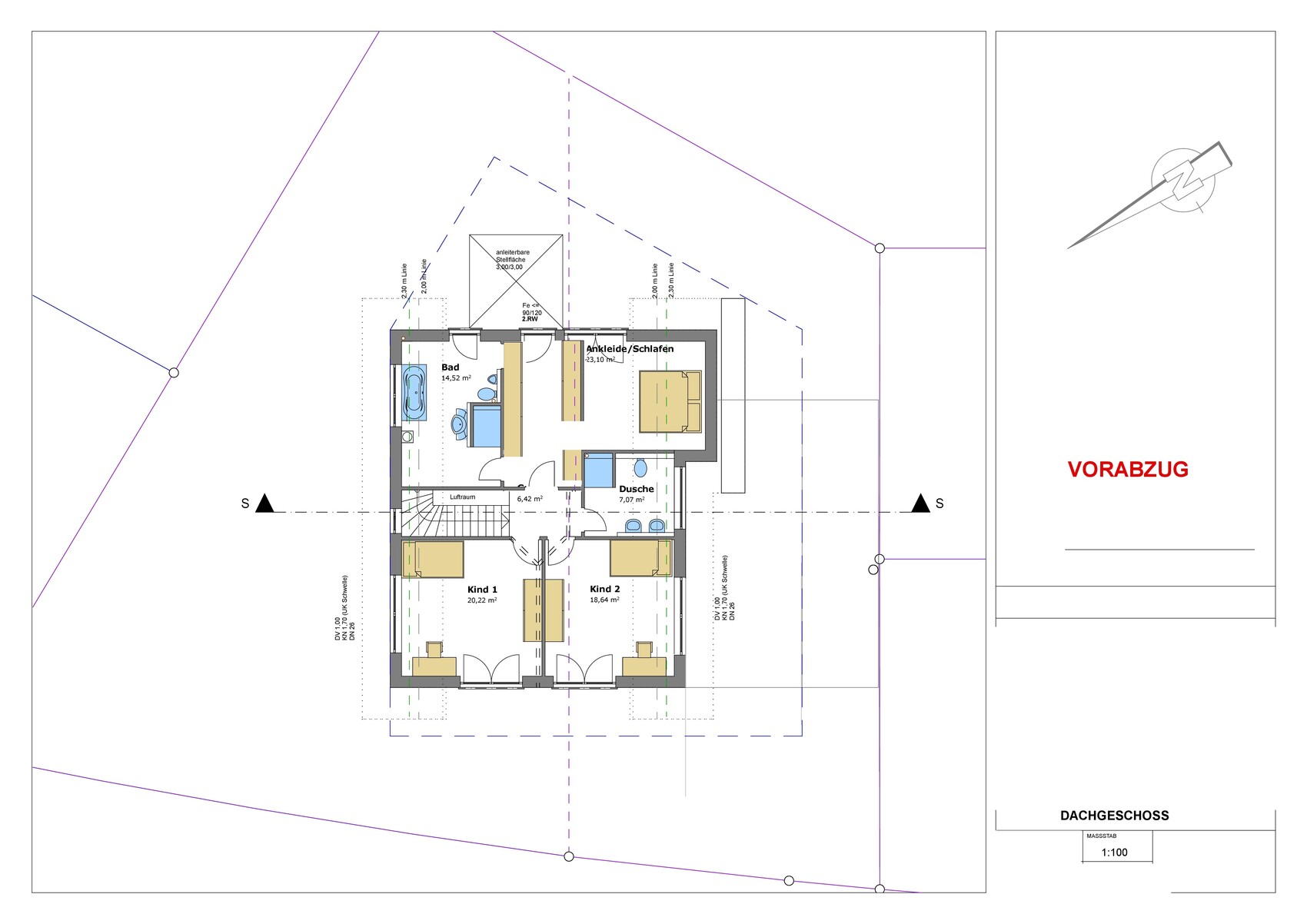

Floor plan of a residential house with garage, bedroom, hallway, technical room and basement.
Floor plan of a house with entrance hall, guest room, kitchen, living/dining area and terrace.
Attic floor plan: bathroom, shower, gallery, dressing/sleeping area, child 1, child 2
Modern two-story house view with gable roof, balconies, garage and terrace (NW-SW view).
Modern house on a slope: southeast view with balconies, northeast view with dark roof.
Section through a multi-story residential building with stairs, doors, windows and roof structure.

Just quickly (to be removed) my idea for the upper floor
Attic floor plan: bathroom, shower, walk-in closet/bedroom, two children’s rooms, hallway.
