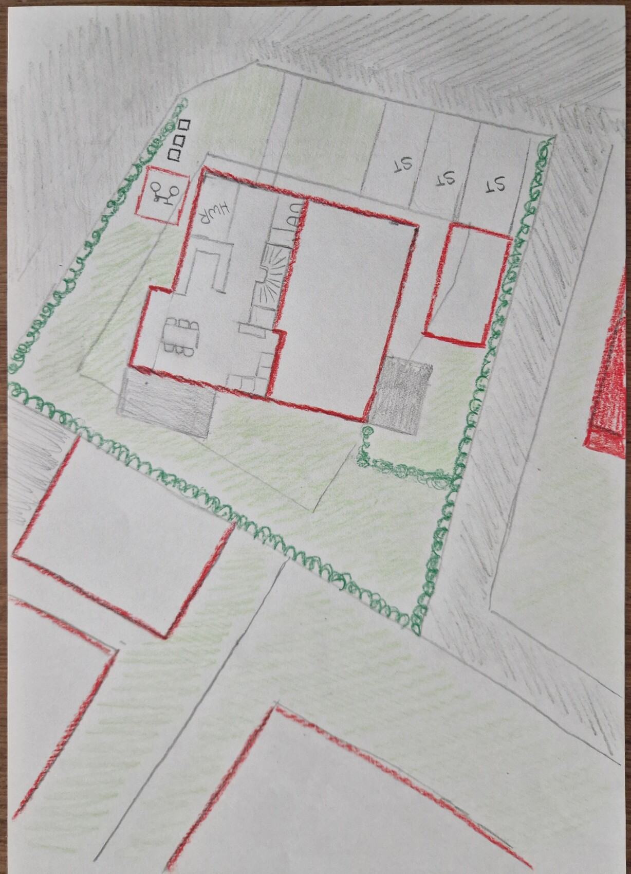

After reading a lot here and planning for three months now, I’m trying to get some help.
The plot is complicated, maybe a bit narrow to also fit a separate apartment on the ground floor.
We are unsure how to “split” the plot.
Who should get the west or east side?
Which street should the house face?
The 5.5 m (18 ft) setback area on the north side suggests itself as the driveway/parking area. Also, no one wants a north-facing garden.
We all want sunlight somehow, but with further construction progress on other houses (marked in red) and the low sun angle, hardly any sun reaches the southern area.
The separate apartment really only needs a sunny terrace (because mowing the lawn will get harder with age).
I’ve simply added the architect’s two drafts here.
kbt09 schrieb:
the more it must be on the east side.So, the granny flat gets the nice east side with morning sun, and the main residence has a narrow, divided garden.
But the main house shouldn't shift too far toward the west street side, or there won't be any privacy left.
To make sure we don’t forget the desired garage (actually, there were two),
it only fits on the east side. You can’t get a proper driveway on the west corner.
The granny flat needs a bike/storage room, which can be placed in that corner (it’s a bit odd, though—we would always have to go to the other side of the house to reach the vehicles—but okay).
So I keep coming back to a rectangle with a maximum width of 12 m (39 feet) and a length of 11.5 m (38 feet).
A bay window or extension could only be added on the west side or next to the garage—I have deliberately left this out for now in case we want a side entrance for the granny flat.
What do you think?
Accurately aligned north/south again.
I really saved a lot of square meters.
The long corridor is just how it is.
In return, there must be a window next to the front door and possibly an open space on the upper floor.
But the upstairs is simply not the problem.
I’m out of ideas for the granny flat:
My mother didn’t like the long, narrow kitchen. She definitely wants an open kitchen with a small breakfast bar—but preferably not right at the entrance.
The dining table should fit 4 to 6 people, plus a small corner sofa and TV wall.
She also absolutely needs the small guest room.
And I would plan the bedroom generously so that a large standard double bed can fit in there someday.
So, emotionally speaking, I feel there is enough living space available for the granny flat.
