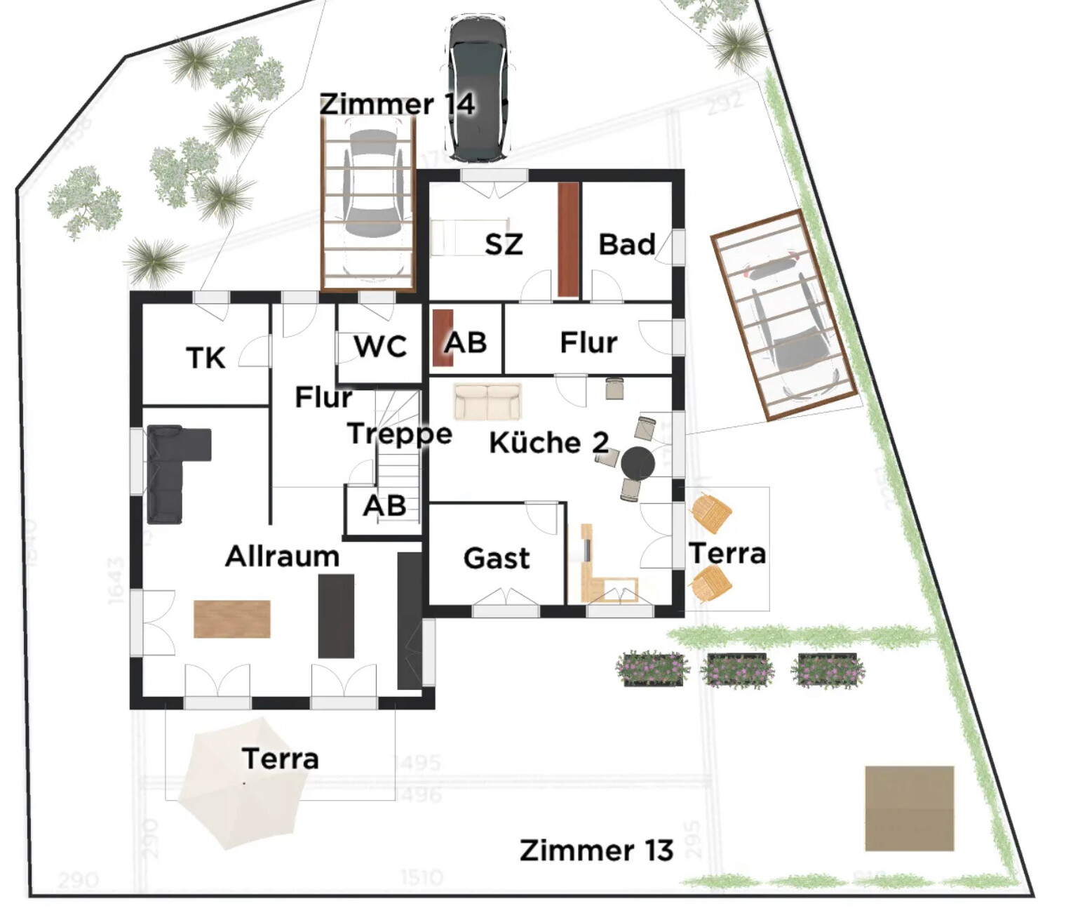

May I share my rough sketch?There was something I missed. Hausmma schrieb:
I already mentioned that it might have been my fault:
I just said: "let’s try swapping the dwelling units" "it’s too small" "add a second garage"It’s okay and recommended to have questions and ideas for the architect, but then it’s their responsibility to review them and convince the client why something won’t work or, if it is feasible, explain the consequences.I haven’t strictly followed the 12 x 12 rule, but I modified the plan again.
I had major issues with the stairs, and I couldn’t make some corners any smaller or larger. However, I personally find the design quite smooth now. I would appreciate one or two of the features. The rooms function well.
The front yard still needs some adjustments.

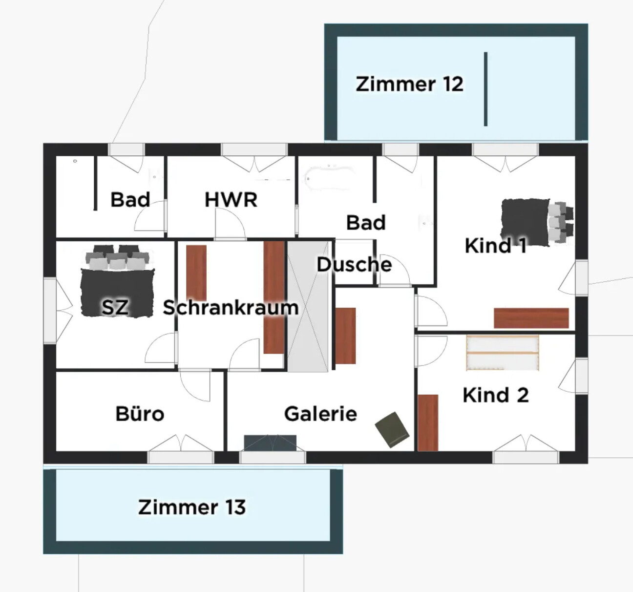

I quite like this. It has an interesting look. The layout is suitable for photovoltaic panels, and the terrace of the larger apartment still receives west-facing sun in the summer. The southern sun in summer is quite vertical, so there isn’t too much shadow from neighboring houses. The offset also creates nice, individual outdoor niches.
The upper floor with the office/walk-in closet, etc., feels a bit like Tetris. I would probably make the office accessible from the hallway gallery. That way, the walk-in closet can be a bit narrower, and the master bedroom a bit wider.
The arrangement of the bathrooms/laundry room still needs some fine-tuning, but that wasn’t the primary goal of the design by @ypg. After looking at it more closely, the laundry room between the bathrooms actually has a certain charm, even though the children’s bathroom then requires two doors. These doors are not super critical here, but rather practical, since, for example, the bathtub can be made easily accessible for everyone involved.
ypg schrieb:Could you maybe add some exterior dimensions to the ground floor plan?
I haven’t followed the 12 x 12 rule exactly, but I’ve modified it a bit.
I just skimmed through it.
kbt09 schrieb:That could easily be 15 m (49 feet) wide.
Could you perhaps add some exterior dimensions to the ground floor plan after all?
Yes, that could be the case. However, Yvonne’s design has a good flow and I like it much more than a simple 12x12m (39x39 ft) box. Admittedly, that layout offers quite good plans for a granny flat, but the main living area on the ground floor suffers as a result. Yvonne’s layout solves this issue. As a side benefit, you also get some nice corners in the ground floor garden where you can have sheltered spots protected from the wind and break the line of sight between terraces.
You could also consider replacing the sloped roofs (which I like) with balconies. At least maybe the north-facing balcony. One could imagine that after the children move out, the parents’ bathroom could be converted into a sauna, thus creating fresh air access. Just an idea.

Could you maybe add some external dimensions to the ground floor plan after all? I can of course do that later, although I have to say I didn’t strictly follow the brick dimensions, but rather the layout, furniture optimization, and the building envelope. So, as always, it’s just an idea and should be seen as a rough sketch.
kbt09 schrieb:
The upper floor with office/walk-in closet etc. is a bit of a puzzle. I would probably make the office access from the corridor gallery. Then the closet could be a bit narrower and the master bedroom a bit wider. Yes, the entire upper floor was a puzzle until this version emerged.
This is due to the long and narrow shape of the upper floor, which didn’t work well with the conservative staircase position on the ground floor.
I missed the office door. Good point. That way the bedroom becomes a proper room and isn’t so cramped.
kbt09 schrieb:
The arrangement of bathrooms/laundry room still needs some fine-tuning, Yes, but I don’t see how. You could, of course, move the laundry room to the outside, but then the master bathroom ends up with two doors in a small space.
Or you could do without the second bathroom and create a nice shared one. The bathtub acts somewhat like a room divider, yes.
If the bedroom becomes a bit wider, then the bathroom and laundry room could probably be enlarged a little.
