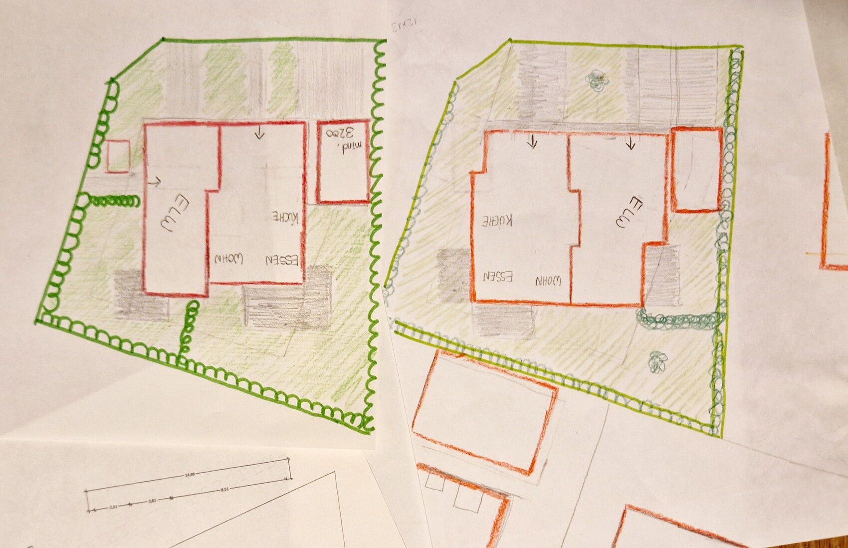

After reading a lot here and planning for three months now, I’m trying to get some help.
The plot is complicated, maybe a bit narrow to also fit a separate apartment on the ground floor.
We are unsure how to “split” the plot.
Who should get the west or east side?
Which street should the house face?
The 5.5 m (18 ft) setback area on the north side suggests itself as the driveway/parking area. Also, no one wants a north-facing garden.
We all want sunlight somehow, but with further construction progress on other houses (marked in red) and the low sun angle, hardly any sun reaches the southern area.
The separate apartment really only needs a sunny terrace (because mowing the lawn will get harder with age).

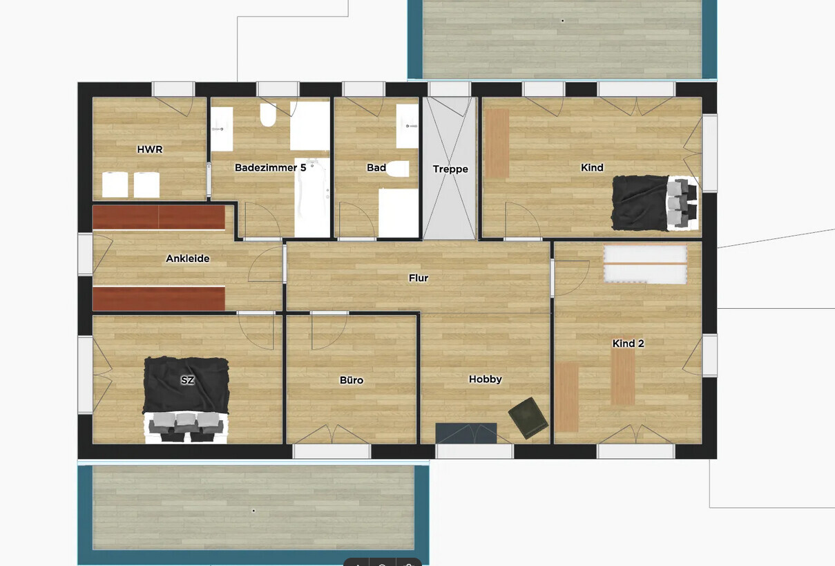

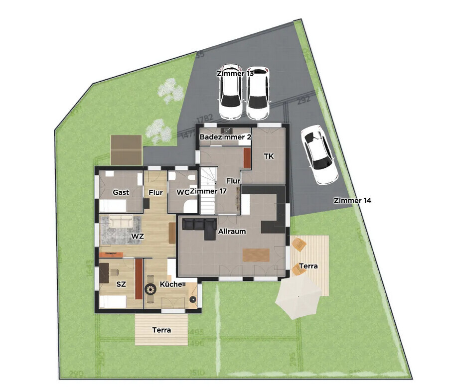

I’ve simply added the architect’s two drafts here.

I have looked at your post with the patient pencil sketch (no offense to pencil or colored pencil drawings – I love them) and I really encounter my, your, our limits here.
But you contradict yourself completely: sometimes it’s the west side you want, then the east side. Then west is a narrow strip, then you absolutely want to go there. Here you even say yourself it’s all rather awkward, garage and storage on exactly the wrong side. Logic is close to envy.
With all these considerations, I personally do not at all come to 12 x 11.5 m (39 x 38 feet) and this kind of layout.
If I roughly follow the sketch with proper exterior walls, I arrive at a ground floor that doesn’t make it worthwhile to even consider an upper floor.
The kitchen in the main apartment is tolerable, but what about the living area? In other plans, you criticized either a hallway that’s too long or one that’s too short, and a kitchen that’s more optimal or too open.
Your mother will complain about car door noises next to her bedroom window but at least she can look into your garden. A south-facing window in the kitchen should definitely be a MUST, right? The guest room is barely 2.2 m (7 feet) wide.
I dug up a draft from last week again:
The views roughly correspond to what was posted before. Due to the stair location, the upper floor is easier to furnish.
The garden shed is at the entrance to the granny flat, you could make a garage on the edge parking space. The utility room/bathroom situation is not fully developed.
Hausmma schrieb:
Yes, then the granny flat gets the nice east side with southern sun, and the main apartment has a narrow, divided garden.
But the main apartment shouldn’t shift too far to the west street side, otherwise there’s no privacy left.
So we don’t forget the desired garage (actually there were supposed to be two).
It simply only fits on the east side. You can’t really get a proper driveway on the west corner.
The granny flat needs a bike/storage room which could then be placed in the corner (which is a bit strange, we would always have to access the vehicles on the other side of the house – but okay).

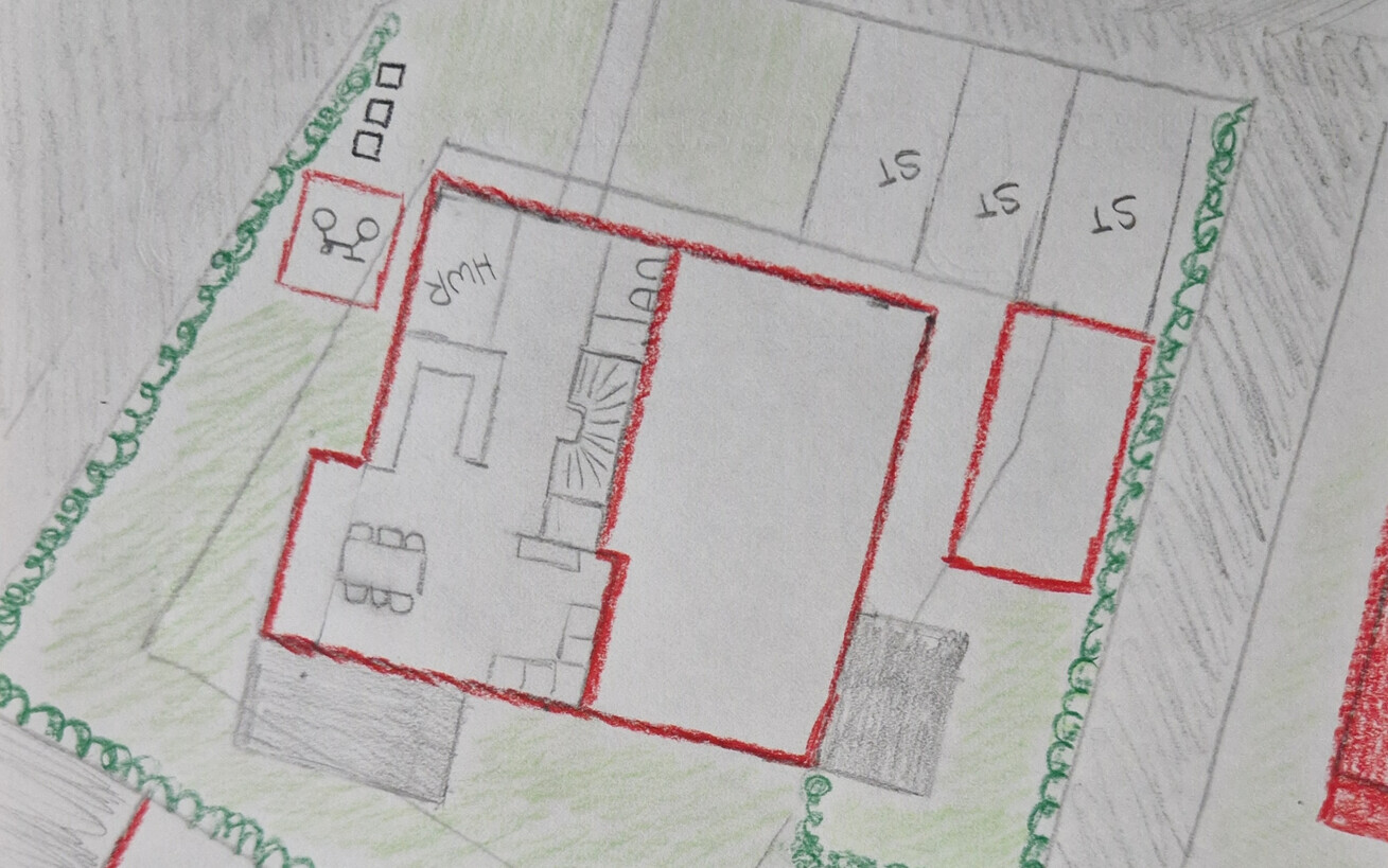

I dug out a design from last week againDefinitely the best one, but the 3-meter (10 feet) setback from the street is too little. A 3-meter (10 feet) garden is already quite small—and if a 1-meter (3 feet) wide hedge has to be planted there (according to zoning regulations), only 2 meters (6 feet) remain.Therefore, we are still leaning towards aligning the house straight.
