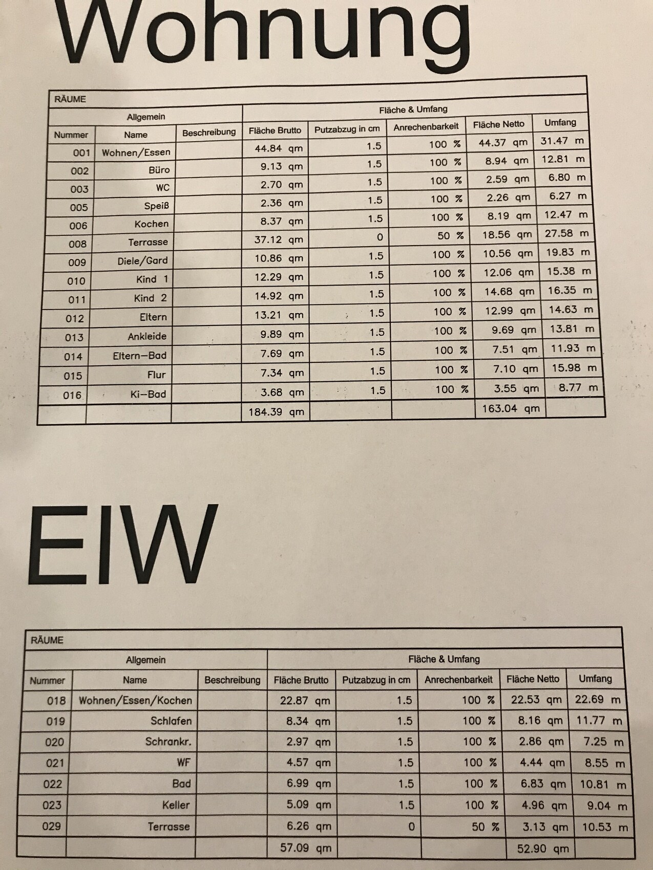

Kadir198927 Feb 2020 06:16Hello,
Yes, the site plan is oriented to true north.
In the northwest view, you can see the entrance of the secondary unit. Its car is also parked there.
I still have the room layout available in square meters.
The secondary unit is 52 sqm (560 sq ft) net.
My two floors together are 145 sqm (1,560 sq ft) excluding the terrace.

The entrance to the granny flat is on the northwest side. To be honest, I’m out. Northwest doesn’t exist. Where is the garden supposed to be?
I’m usually not slow to understand things, but I don’t get this layout. 420 m² (4,521 sq ft) for a house without a garden? Two driveways?
The room sizes won’t help me or you if the dimensions only allow for poor furnishing. Because upstairs, you basically have just narrow hallways...
A few measurements would be helpful. The children's rooms are difficult to furnish. I also find the parents' area too large in proportion to the children's rooms.
What should be included in the 500 K?
Why add a granny flat on this tiny lot? Even more parking spaces, another house entrance. Won't that leave any space for the garden?
Somehow I can't make sense of the floor plan and site plan together.
