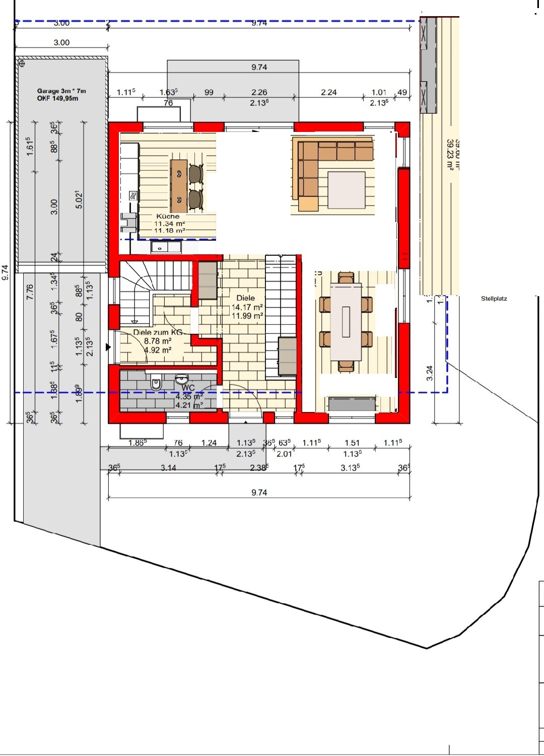

NicoleflHello everyone,
We already have a finalized floor plan for our single-family home with a granny flat. The building permit application has been submitted. Unfortunately, during the eight months of waiting for the approval, some uncertainties about the floor plan have arisen. We cannot change the exterior dimensions anymore, but the interior layout feels off.
A quick note about the granny flat: it is intended for my parents. They will be living partly here and partly abroad. We do not want them to access the granny flat through our main apartment. A separate entrance is important, even though it is a bit inconvenient that we have two staircases. Later, the granny flat could be used by our son when he is older, or it could be converted into a hobby room, or something else.
On the ground floor, I would much rather have the kitchen where the living room is now, including a kitchen island. The problem is that the living room would then have to move to where the kitchen currently is, which at 3.13 m (10.3 ft) is far too narrow.
On the upper floor, a small storage room could be added just after the stairs to house the washing machine and dryer.

Garage, carport: garage 7 × 3 m (23 × 10 ft)
Other wishes/special features/daily routine, including reasons why something should or should not be included
Swapping the living room and kitchen would allow conversations on the couch in the evening without it being too noisy upstairs (due to the open space).
Designed by: our architect, but the plan is not quite right.
What do you like most? Why? Not much, actually
What do you dislike? Why? The combined living, dining, and kitchen areas are too narrow.
Price estimate by architect/planner: 450,000
Personal price limit for house, including fittings: 510,000
If you have to give up something, on which details or features could you compromise?
Can give up: floor-to-ceiling windows on the upper floor
Cannot give up: straight staircase and the open space; I’d rather not lose those
This is the third version from our planner, which we initially liked, but now we are uncertain.
The number of rooms, open space, and straight staircase have been considered.
The living/dining area is too small and too narrow.
Development Plan/Restrictions
1. Would swapping the living room and kitchen be sensible? The future living room would need to be made wider since 3.13 m (10.3 ft) is too narrow.
2. Could a storage room be planned on the upper floor, possibly after the staircase?
3. What do you like or dislike?
I appreciate any suggestions and advice.

Nicolefl schrieb:
The building application has already been submitted. Unfortunately, during the eight months of waiting for the building permit / planning permission, some uncertainties regarding the floor plan have arisen. We won’t be able to change the exterior dimensions anymore, but the interior layout isn’t quite right. Then it will have to remain as it is, unless you want to go through the whole process including the lengthy timeframe again. Significant changes will require a new application, so keeping the same exterior dimensions won’t help. There are two things I still don’t understand: the roof structure and the building’s projection about 1 meter (3 feet) in front of the setback line towards the street.
You have shot yourselves in the foot twice, with the air space and the square shape of the house footprint, in addition to the already high density of wishes and requirements for the house size. Am I correct in assuming that the design was developed from a catalog suburban villa?
Considering the house’s borderline small “size,” I find it surprisingly and remarkably well-balanced as a compromise. I would personally simply remove the air space and would have skipped seeking an exemption from the setback line—is that significantly responsible for the long processing time?
It seems to me that with your clever draftsman, you almost lost an architect, who apparently couldn’t convince you to drop the air space after all.

Nicole I can’t comment on the floor plan itself, as ours has been criticized frequently 😎 I also didn’t find how large the house is supposed to be, but I estimate around 200 m² (2,150 sq ft). I would question how the architect arrives at just €450,000 for that. It looks like a lot of earthworks will be needed, which means high costs. Because of the small plot, the soil will probably have to be removed entirely, adding even more costs. Architects have the advantage of often designing attractive floor plans, but they don’t always account accurately for cost estimates…

Nicolefl schrieb:
On the upper floor, a small storage room could be created just after the staircase landing to accommodate the washing machine and dryer. Where else, if not in the open space?
Nicolefl schrieb:
Swapping the living room and kitchen would have the advantage that you can chat on the couch in the evening without it getting too noisy upstairs (because of the open space). And what about the clattering of dishes when unloading the dishwasher in the evening or entertaining guests?
Nicolefl schrieb:
but the layout is not well thought out. Exactly. Good that you noticed that yourselves.
I would avoid switching the rooms: 3.10 meters (10 feet) is enough for a kitchen run plus an island or a double-run kitchen. As far as I can see, the best part of the plot is where the kitchen is now: I would enlarge the windows there (west and northwest) and create the dining and evening terrace.
I could imagine closing off the kitchen passage at the lower end near the staircase, then having two kitchen runs. Floor-level windows on the north and west side. This way, you don’t have to constantly walk through the quiet zone.
Basically, I would question the window placement on the upper floor, why it is designed almost like an attic apartment, with no windows planned on the east and west sides, which are important for the sleeping areas.
A tip for the entrance: align the apartment door with the main entrance door; this creates a double-sized cloakroom area!
Apart from that, and then the design will also work.
