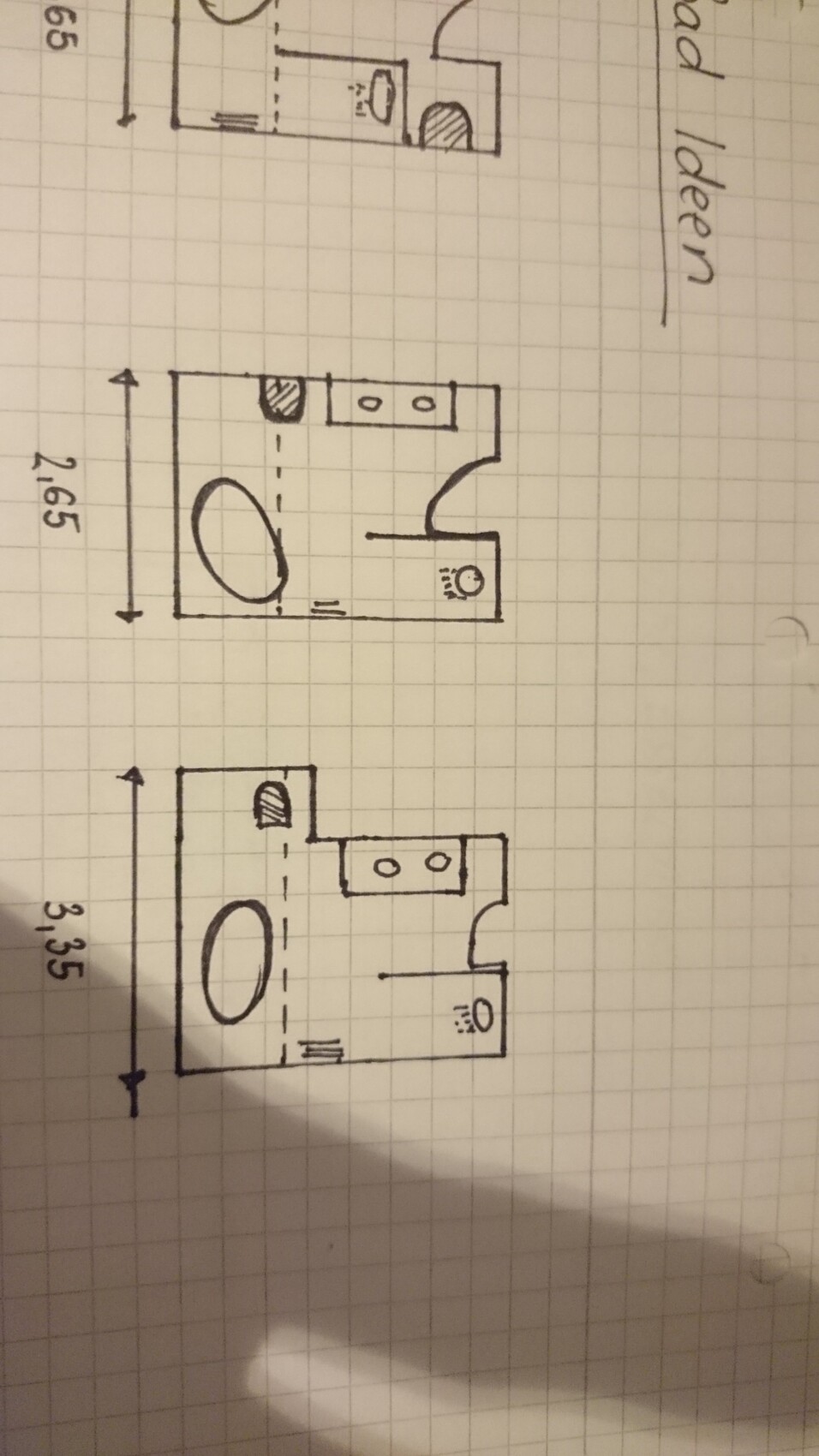

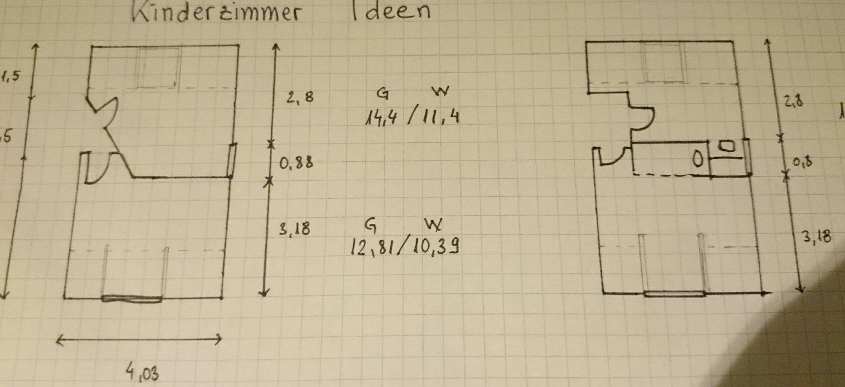

Attached are the fireplace and the kitchen modification, as well as the enlargement of the bathroom upstairs and two ideas for children’s rooms, all sketches.
Karlstraße19 Sep 2015 23:12The kitchen and living area shown above has a depth of 720 cm (284 inches)... if you want to arrange the furniture like this, it will be tight, very tight.
Also, the fireplace location significantly limits the dining area.
And having two children’s bedrooms on the right side of the upper floor... it just becomes cramped. Moving one children’s bedroom into the home office on the ground floor... well, I’m not sure, especially regarding access from the dining area?
I simply see too many things that don’t fit here.
Take a close look at your upper floor plan:
The 318 cm (10 ft 5 in) is not the interior dimension on the right side of the plan; the maximum is likely 297 cm (9 ft 9 in). Try placing beds in the rooms along with at least 100 to 150 cm (40 to 60 inches) of wardrobe space, and then see if you can still fit a desk.
kbt09 schrieb:
Those will just be small little closets,Exactly! Children are not really welcomed in your home, are they? Toddlers might get by with 10 sqm (108 sq ft), but teenagers? Are they supposed to “play” outside or sulk in the basement?
