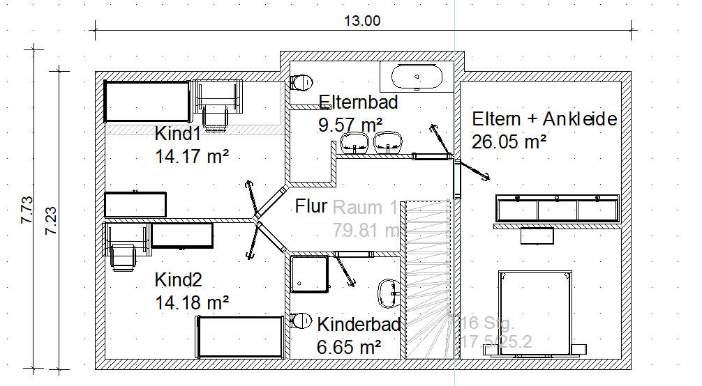

So, children's rooms under 12m2 (130 square feet) are simply no longer practical nowadays. After all, children grow older. If necessary, I would skip my walk-in closet and instead provide the kids with a proper bedroom.

19 Sep 2015 12:59
So, I put together a quick draft. The exterior dimensions should remain the same. I only modified the upper floor to show an alternative layout for that level. Wall thickness and other details would still need to be adjusted, and the main bathroom would require careful planning regarding drainage, as it is not ideal on the ground floor :-/
Floor plan of a family house: master bathroom, master bedroom with walk-in closet, 2 children's rooms, children's bathroom, hallway.
