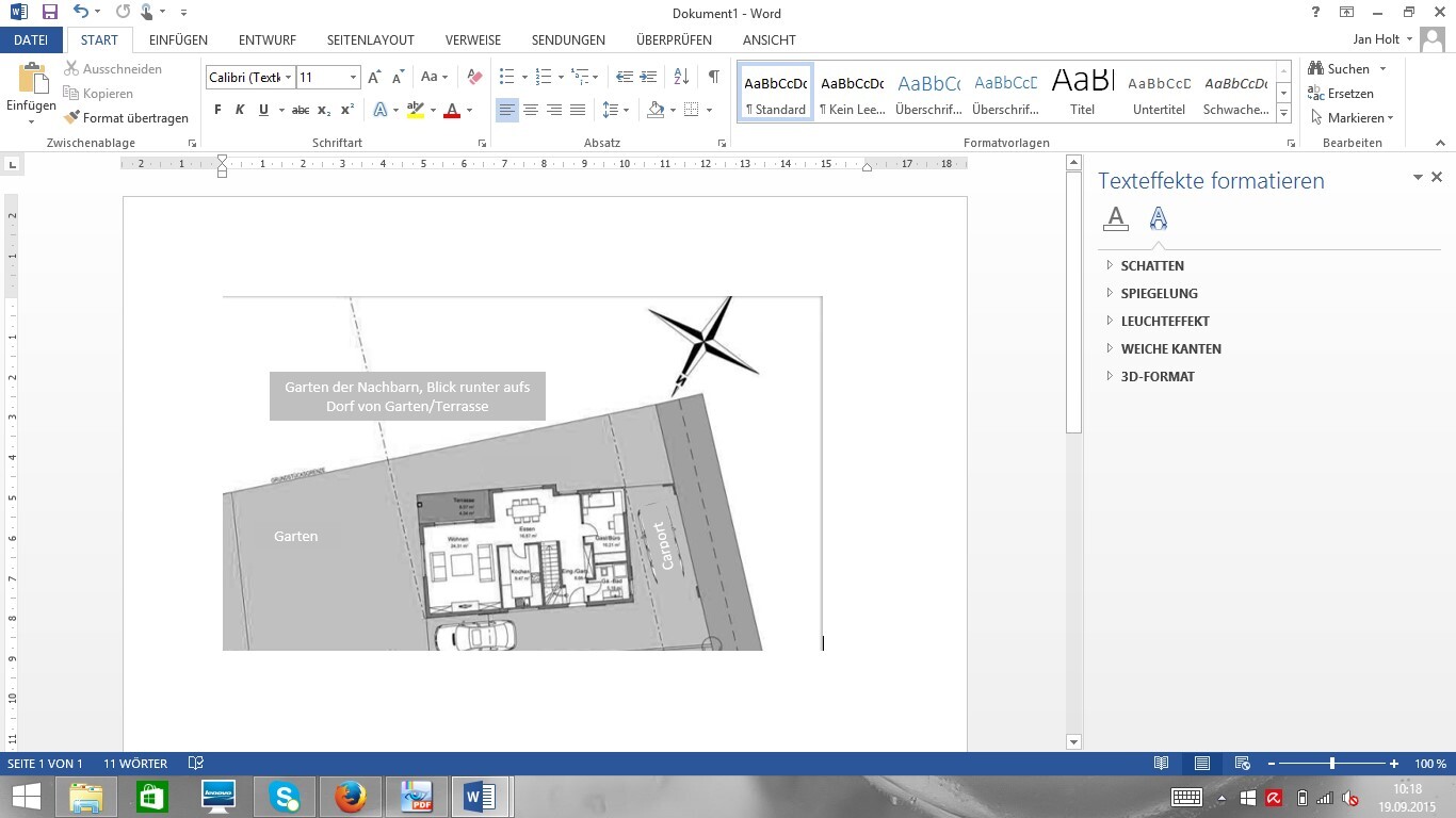

Karlstraße19 Sep 2015 10:24Hello,
sorry, here is the site plan. The slope is minimal (from east to west).
There is a carport on the right, and a parking space may be possible in front of the house.
The road to the right of the carport is a bike path, not a regular road.
Regarding the children's rooms, we are also uncertain. It is important for us to have two rooms of 10 sqm (108 sq ft) each upstairs… our current idea is to divide the dressing room and the bedroom on the right.

Karlstraße schrieb:
Regarding the children’s rooms, we’re also figuring it out. It’s important for us to have two rooms of about 10 m² (108 sq ft) upstairs... Our current idea is to split the dressing room and the bedroom on the right. Those would then be quite small, especially since there is the sloping roof, and you’ll also need a solution for access to two rooms. The knee wall is only 100 cm (39 inches), and roughly measured, the 200 cm (79 inches) height line only starts after about 120 cm (47 inches).
Is it not possible to change anything about the window or gable positions? What does the architect’s proposal look like regarding your room requirements?
- The bathroom and front door conflict (from personal experience, it’s frustrating when no one can use the bathroom while you’re seeing off a guest)
- The path to the kitchen is long
- What kind of 24cm (9.5 inches) wall construction is that?
- Somewhat awkward free space next to the dining table
- No central circulation area on the ground floor (feels like a corridor)
- The attic floor does not meet your requirements
